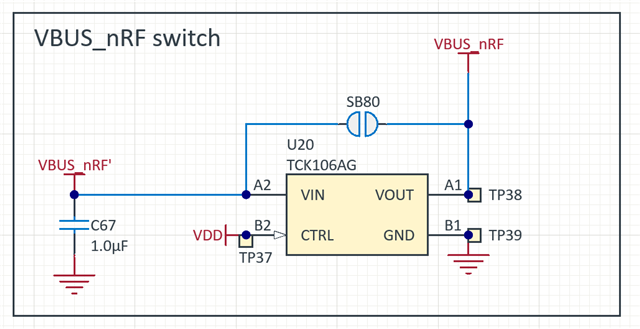

VBUS_nRF Switch on nRF7002 DK
I am developing custom hardware based on this DK and am trying to eliminate circuitry that is unnecessary to my application. The DK includes a U20 load switch which automatically turns on when USB VBUS is applied. The DK also provides a solder bridge bypass option. I am unable to find a sequencing specification in the nRF5340 datasheet that says VDD must be applied before VBUS. The presence of this switch implies there is a sequencing requirement. So, I guess my question is, is this switch necessary for a minimal application hardware scenario? If I remove this switch then VBUS could come up before VDD. Would this present a reliability problem? How about if VBUS were present with VDD no applied at all?
Thank you,
Chris
