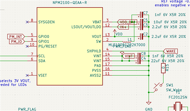

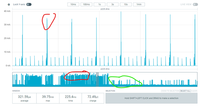

    I'm into energy measurements again and I noticed, that shaking our vibration sensor leads to high energy consumption (in schematic it is connecting SHPHLD to GND with 0R, like mentioned in the reference design) of 30mA peaks (red markings). Without shaking, those peaks are gone. The peaks are in 30ms interval.
    Can you assist? Do I need apply a resistor? I think this could be problematic, as it would affect the wake-up.

    What is the supply voltage and output voltage in this case? Do the current peaks align with the boost refresh cycles or TWI/INT/GPIO activity?
  • I think I found this issue, but directly went into the next one. GPIO was the hint you just gave. I think, the Interrupt GPIO I configured above has some failure, as it is always GND-level and therefore, when the SHPHLD triggered the GPIO, the consumption went up. I fixed this, by deactivating the GPIO as interrupt output.

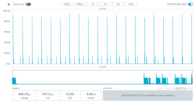

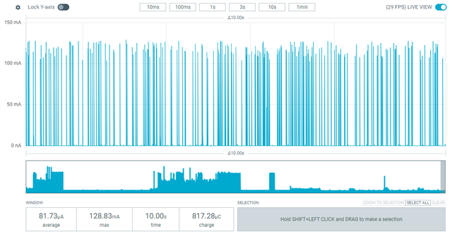

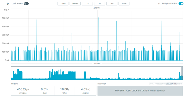

    During idling (no BLE, CPU sleeping in 10s interval with basically no operation) it draws 90µA with peaks of 120mA (measured at VBAT)
    With BLE active (using the nRF BLE tool) it rises to 460µA having peaks of 510mA:
    Schematic should be like reference design (won't be able to share publicly in full):

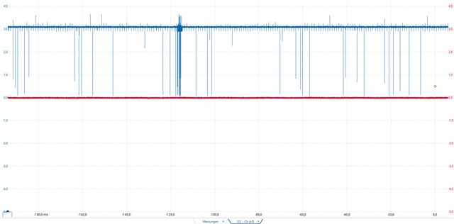

    As I do not now, what exactly is creating this peaky charging, I measured the voltage L1 (SW):
    I already replaced C5 and L1.
    Can you provide any hints?
    It seems the inductor used in the schematic is not suitable for this device. Please see nPM2100 HW Design Guideline for more details on selecting the inductor: nPM2100 Hardware Design Guidelines
    Inductor saturation and high ESR will cause increased current consumption and high current spikes from the battery.
    If we assume you are using 1.5V battery and output voltage is set to 3V, the no load battery current of nPM2100 should be 200nA averaged over long period of time: So if it is in tens of uA range, that is too high. Higher current spikes are expected when the boost does the refresh cycle. The peak value depends on the input capacitor, but tens of mA is considered normal. Not sure about the load on the output can the current go there?
    GPIO configuration is also something worth checking. For example if the GPIO is set to CMOS output (not OD) and pull up/down resistor is activated, it will cause increased current consumption. Also check that the GPIO configs on both sides, host and PMIC side are set correctly to avoid the GPIOs fighting each other. IO levels on both sides should be also checked that they are compatible.

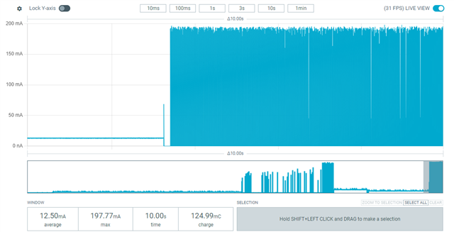

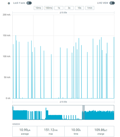

    I also tested the nPM2100-EK and turned on the low load (13mA at LDSW 1.8V VOUT). With VBAT=3.446V everything looks fine (BOOST is off). But with VBAT=1.2V the input current peaks to 200mA (at least average consumptions stays at 13mA):

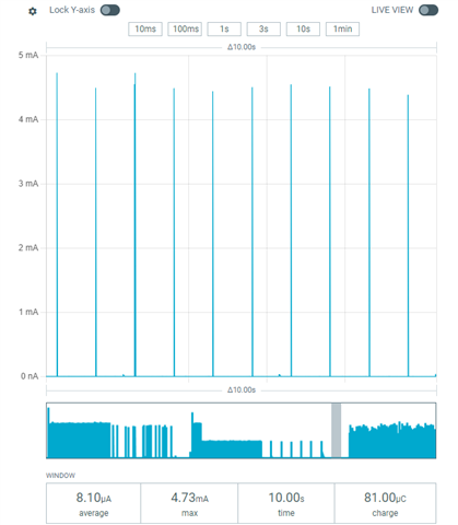

    As measuring consumptions on VDD and LDSW would be very hard, I thought it would be a good choice to start with measuring consumptions with having VBAT > VDD (3V). I started with VBAT = 3.446V, using the PPK2 as source. The power measurements are pretty clean now:
    Hibernate: 0.33µA | max 2.66µA
    High, BLE com: 640µA | max 92mA

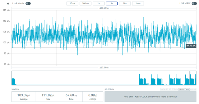

    (B) there's still 105µA consumption, when LDSW is off and only nRF54L15 is idling in:
    k_event_wait(event, 0xFFF, false, timeout);
    I tried to set up theoretical consumptions from datasheet and some mearuements:

    All in all we should stay below 90µA mean (not 640µA). I would hope even less... But I can still tweak consumptions of Radio TX and Sensor. Any advice, how to check the CPU states/state times?
