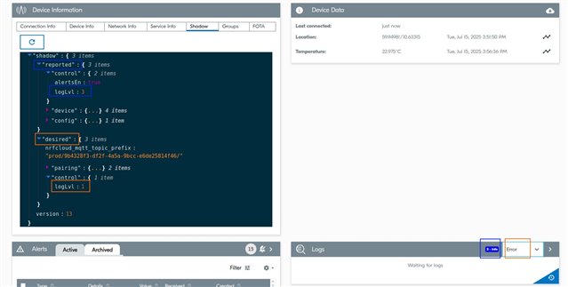

    This is a feature that leverage Zephyr's Logging subsystem. nRF Cloud received the logging and displays it in the Logs Card. This is also available for binary logging for a smaller memory footprint.
    The Logs card's UI allows you to select which is the desired level of logging you would like to visualize in the cards but this is not something that is being filtered in the front end neither in the back end of nRF Cloud. When you select the desired log level, this will be changed in AWS shadow and wait for the device to connect to nRF Cloud to catch this new desired value (which is considered a delta) and execute in the application the desired configuration changes. Once this is done, the device reports back the current state, this is then visualized on the left side of the options to select in the Logs card. If you pass your mouse on top of it, it will describe what I'm mentioning.
    As you can see in the picture above, I remarked on blue the "reported" by the device and in orange the "desired".

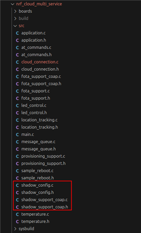

    If you look at the Multi Service sample, you will notice there are a few files that controls the Shadow control on the device. There are some specific for CoAP and MQTT. If your project lacks of shadow support and has nRF Cloud logging enabled, the device will send the log to nRF Cloud but you will not be able to control the device.
    My recommendation would be to compile the Multi Service sample with the overlay_nrfcloud_logging.conf and see how this changes.

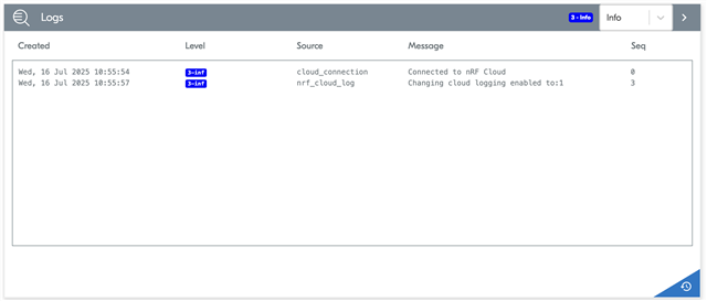

    2. Ran the sample for 15 mins. Got the following logs in nRF Cloud:
    No actions - no logs. This is the expected behavior. Right?

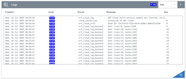

    3. I made one more modification in the overlay_nrfcloud_logging.conf. Set CONFIG_LOG_RUNTIME_FILTERING=y (as I've written above - this option breaks the log filtering). This is the diff:
    @@ -11,7 +11,7 @@ CONFIG_NRF_CLOUD_LOG_INCLUDE_LEVEL_0=y
     # If enabled, log levels for each log source can be set per log backend, and
     # can be changed dynamically.
    -CONFIG_LOG_RUNTIME_FILTERING=n
    +CONFIG_LOG_RUNTIME_FILTERING=y
     CONFIG_LOG_BUFFER_SIZE=4096
    @@ -28,3 +28,7 @@ CONFIG_LOG_BACKEND_NRF_CLOUD_OUTPUT_TEXT=y
     CONFIG_LOG_PROCESS_THREAD_STACK_SIZE=4096
     CONFIG_LOG_PROCESS_THREAD_SLEEP_MS=30000
     CONFIG_TEMP_ALERT_LIMIT=24
    +CONFIG_LOCATION_TRACKING=n
    +CONFIG_TEMP_TRACKING=n
    4. Ran the sample for 15 mins. Got the following logs in nRF Cloud:
    Still no actions - but much logs (and they never end). Is this the expected behavior? I believe - not. And I see the code in nrf_cloud_log_backend.c that should prevent this behavior. But it actually doesn't work (see our explanations in the previous messages).
