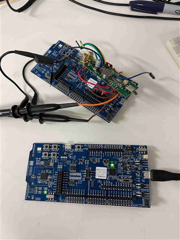

I have recently bought two nrf52840dk, version 3.0.0, unboxed and plugged into usb. One would show up with a usb storage on the side and in vscode a J-link window prompted for a device update on the interface nrf5340 chip on the dk, but the other one doesn't have either. How can I factory reset the non working one? Here are some logs to show.

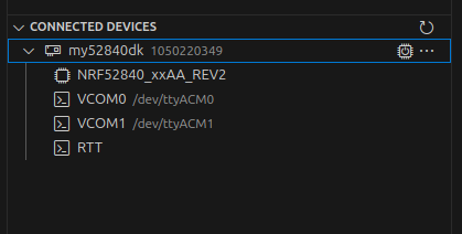

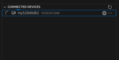

VSCode nrf connect extension
Working one:
Non-working one:
    We have two versions of the On-Board debugger. One with the sticker on the chip (the old one), and one with the sticker directly on the PCB (The new version).
    This will work for the new version, which should be the one that you got:
    Hold the reset button while plugging in the USB of the DK. You will see no change, but the On-Board Debugger should now be in recovery mode.
    Run "nrfutil device x-update-debug-probe-firmware"
    This should update the firmware on the On-Board Debugger. So if it is a software problem, then this should fix it.
