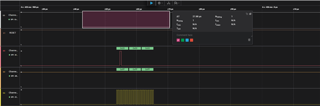

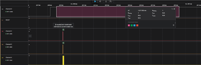

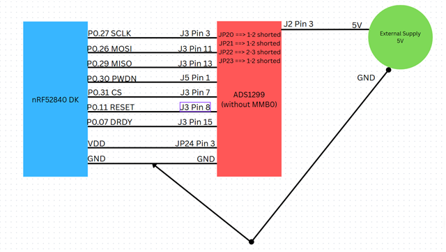

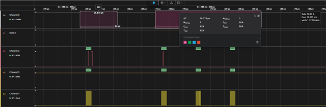

MISO line mimics the MOSI line in SPIM configuration sdk 17.1.0

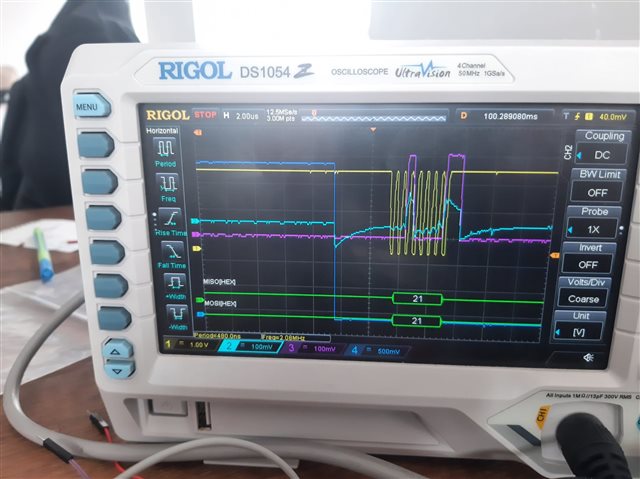

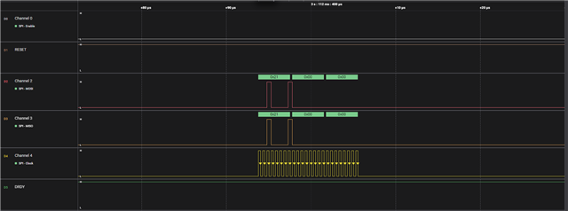

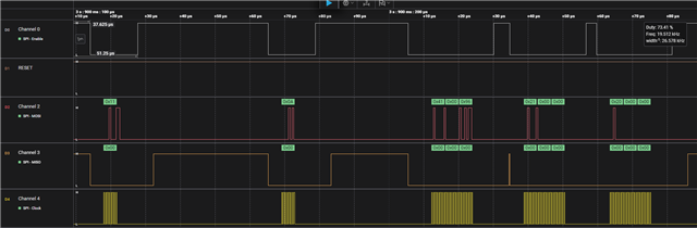

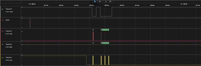

When I looked at the SPI lines using the oscilloscope, I saw that the MISO line had the same signal as the MOSI line. As you can see from the image, basically SPI configuration works properly. Before message transfer CS pin goes low, and after that, the MOSI line works. I can read message that I sent using the oscilloscope.
What can be the problem with the MISO line signal reflecting the MOSI line signal? The SPI config stage CPOL = 0, CPAH = 1, I am using a 2 MHz clock signal. Thanks for your help.

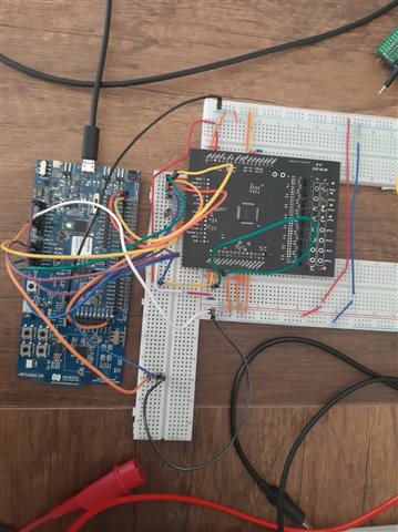

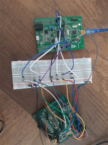

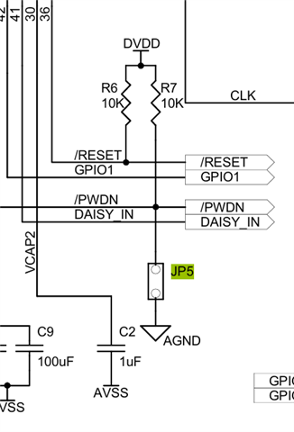

  • Schematic. Looks to me like MISO was never driven at all and is just floating. The voltage change results from coupling to MOSI and clock signal.
    MISO is supposed to be driven by the slave when CS=Low. Check that its properly connected.

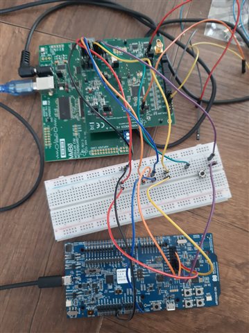

  • Sorry for the late response. All physical pins are connected properly, but I did not understand the problem. During the SPIM configuration, I just initialised the MISO pin. I am sharing my ADS1299 library code with you, Maybe the issue is about the software configuration of the SPIM. I checked the working mechanism of the SPI with ADS1299, and it looks like it was working properly. Again, thanks for your help.

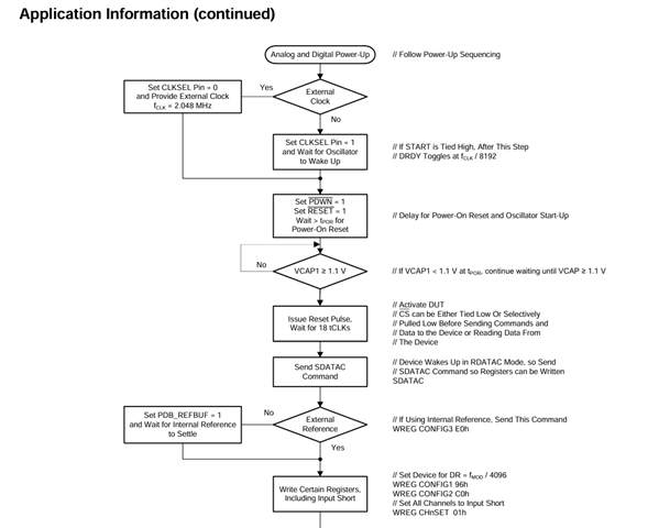

    bool ADS1299_init(void) {
        // recommended power up sequence for ADS1299
        delay_init();
        nrf_delay_ms(50);
        NRF_LOG_INFO("Initializing ADS1299");
        nrf_gpio_pin_clear(RESET_PIN);
        nrf_gpio_cfg_output(RESET_PIN);

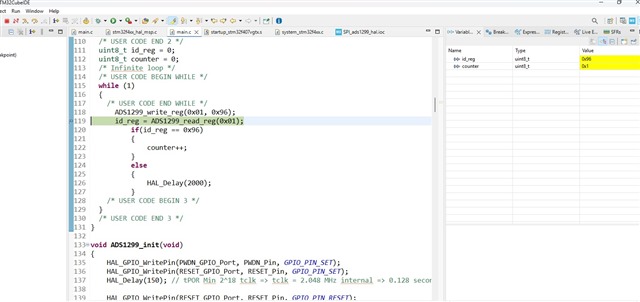

        nrf_delay_us(4);
        nrf_gpio_pin_set(RESET_PIN);
        nrf_delay_us(20);

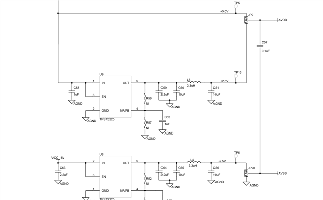

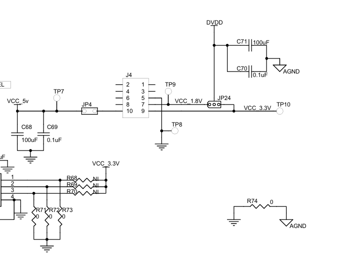

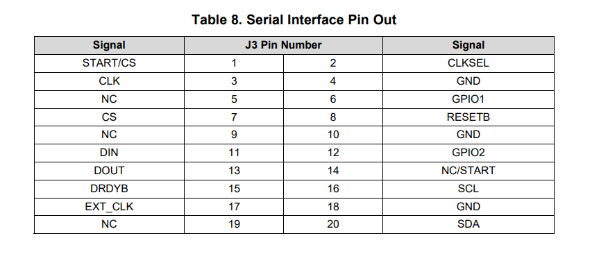

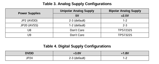

  • In my ADS1299_EK_MAN schematic (SLAU443 dated May 2012, YMMV), J2 is a dummy connector without any pins connected.
    No further discussion from me on this platform about this issue. You clearly have not a problem on the nordic side, and they can't really help you here further either.
  • Look at the trace diagram in the user manual, the square pin on 3-pin JP21 and 3-pin JP22 headers indicate which end is pin 1. JP21 and JP22 both have pin 1 connected together and both connect to J3 pin 1. Therefore assuming the schematic is correct you are using the wrong jumper position if you want SPI_CS on P0.31 and J3 pin 7: therefore change jumper on JP21 to the 2-3 position.
    J2 is shown as a dummy connector; where is the 5V going?
  • Based on the traces, J2 is not connected because I am not using the MMB0 board. Therefore, I am connecting 5V to the third pin of JP2. I believed that when I connect 5V this way, it would supply power to the board. Thank you for clarifying the SPI_CS. Following that, I moved the SPI_CS pin to the third pin of JP21. Thanks for your reply  .
  • Edit: Photo shows J2 but I misread your last post - I see you now have JP2 not J2
    J2 is only present for physically attaching to MMB0 board; there are no electrical connections to J2 on the ADS board according to the ADS schematic. The MMBO 20-pin connectors are connected in parallel, but ADS J2 goes nowhere. For reference this is the MMBO schematic:
    1121.MMB0_Sch_RevD.PDF
  • Thanks for your reply  . I am taking up too much of your time. So basically, I want to discuss the general following path of the configuration. Using the same configuration architecture, I created a simple SPI test with nRF52840DK as the master and Arduino Uno as the slave. As a result, I achieved successful communication between them. I can now read and write values to the Arduino Uno via nRF52840. On the other hand, ADS1299 configuration fails every time. According to our discussion, we end up with a power management problem.
    The point I want to make is that, if I follow the path I have outlined below, can I also establish communication between the ADS1299 and the nRF52840? If the problem I am experiencing is not a configuration problem, can I get a system ready for communication once I solve the power problem?
    Thanks for your reply.
  • Yes. Also note JP2 pins 1 and 3 rely on an external 5V supply which is required. Good luck ..

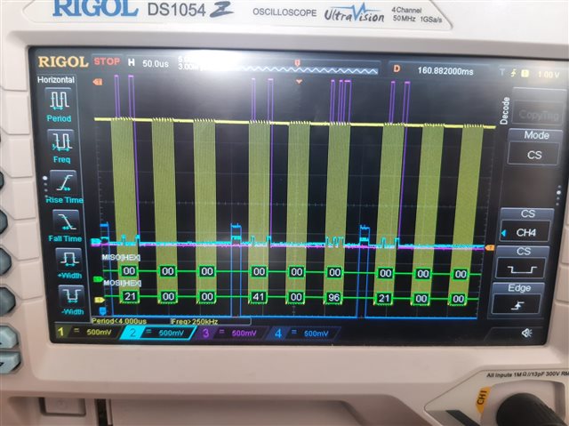

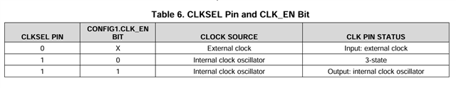

  • Sorry to bother you again  . I have a new board. I am feeding the AVDD with 5V and the DVDD with 3V from the nRF52840DK. I know the picture doesn't help, but I put the ADS1299 chip on the board and brought all the pins out. So, I am getting this result: MISO line returns 0x00 all the time, but it shows like toggling. I am supplying voltages from the nRF52840DK. I am using 5V to 0 as an AVDD-AVSS. I cannot get any response. I controlled VCAP1, and I measured it as 1.2V. Really, I do not understand where the problem is. I did not change anything in my code.
  • "To secure correct behavior in the SPI, the pins used by the SPI must be configured in the GPIO peripheral as described in Table 69: GPIO configuration on page 288 prior to enabling the SPI."
    CS, SCLK, MOSI and MISO pins must all be configured before the SPI is enabled; your code has these commented out. Additionally to start testing don't use SPIM_FREQUENCY_FREQUENCY_M4 but instead start with 500KHZ and only try to use a faster clock speed once you have basic functionality.
  • I modified the code based on your suggestion. According to the datasheet of the ADS1299, after the power-up sequence, ADS1299 enters RDATAC mode. I checked the DRDY pin, but there are no DRDY pulses after the power-up sequence. I am confident the power-up sequence works correctly because during this process, VCAP1 rises above 1.1v. Additionally, on the TI website, it states that after the power-up sequence, VCAP2 should be (AVDD-AVSS)/2, but it shows 0v. Could this be the issue?
    Edit:
    When I give the START pin a high voltage, the DRDY pin starts to toggle.
