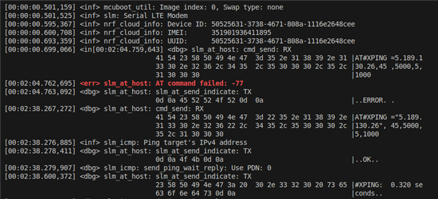

  • Hello, and thanks for sharing. I've had some more time to review the issue and this looks like an issue with the escape characters that are needed when sending these commands over UART. This is typical for the misc shell programs i.e. AT#XPING=\"5.189.130.26\",45,5000,5,1000
    Could you also include CONFIG_SLM_LOG_LEVEL_DBG=y in your SLM application?
    Øyvind
  • Yes, that was it! Many thanks! In the screenshot, you can see the first original message and after with the added \. I had a feeling it was something to do with a character, but I couldn't figure out which one. Debugging would have helped me here Sweat smile.

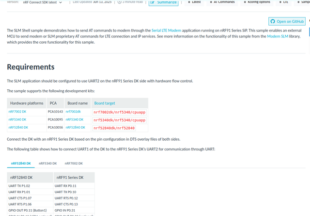

    Also extra question, since in the newer V3.1.0 SLM and SLM Shell both mention with flow control, is this now recommended and maybe in the future required? my setup has no flow control, but does still work.
    Could you please point me to where this is stated? The nRF9160DK has virtual serial ports that uses Request to Send (RTS)/Clear to Send (CTS)-style Hardware Flow Control (HWFC). This may be the reason it states this, and most likely actually include HWFC in your applications.
    Øyvind

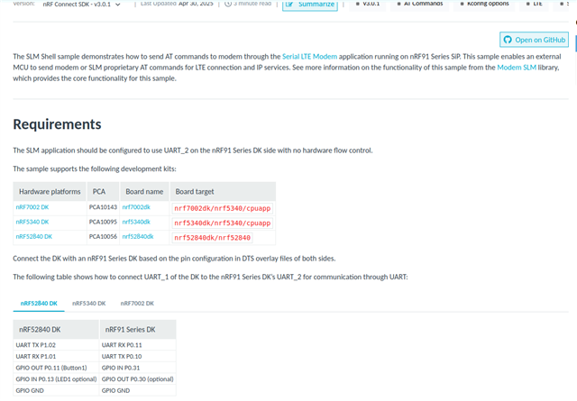

  • Ok thanks that is clear
    In the SLM: Shell sample version latest:
    In the SLM: Shell sample version 3.0.1 and earlier:
    the SLM itself has always stated for flow control to be enabled. so this was mismatched before. But it also works without.
