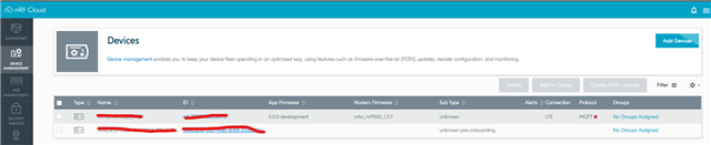

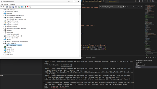

The problem I am encountering is that I cannot insert the CA certificate into the nRF9160SiP. Once I have downloaded the JSON certificate from nRF Cloud, I use the Cellular Monitor application.
10:16:22.453 Updating CA certificate...
10:16:22.453 Unable to Write TLS credential
10:16:22.453 Updating client certificate...
10:16:22.453 Updating private key...
10:16:22.453 Certificate update completed
I can't proceed. Before uploading the file, I ran the AT+CFUN=4 command and verified that it was indeed in that state.

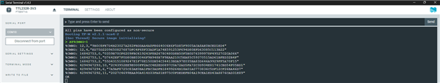

  • Seems like there is an issue with your board then. Does it work if you use the at%cmng command directly?
  • Does it work if you use the at%cmng command directly?
    > AT%CMNG=1
    %CMNG: 12,3,"9B0C8FE7D4B23027A282FBDDAA4A8FE6640C6E6F5D85F9005ACA8AE0BCED1ED4"
    %CMNG: 12,4,"ED75D2209650827687DFC4F68F33ADF1A74E591253F694D80EFD63085C113B22"
    %CMNG: 16842753,0,"0359B70CF6209FBC619243F8B2678C480D8B50F5B0D76399978F49527C2CA066"
    %CMNG: 16842753,1,"D7642EF7F0D80BE03046F9B948B7F9EAA210C5EA85C59370515AD61BFED32B4F"
    %CMNG: 16842753,2,"55D43151089247E1F78E150DB54C34413BDA97E035BA83D646A9929FF5A70F15"
    %CMNG: 4294967293,10,"2C43952EE9E000FF2ACC4E2ED0897C0A72AD5FA72C3D934E81741CBD54F05BD1"
    %CMNG: 4294967294,6,"7A9AF8725C83AE0BA1FBC3ADFB18499264B18A01A0773836C5DF12CF26BA46D7"
    %CMNG: 4294967292,11,"2027C4699EAA90A414D33FA81B975C0FDEDEFB04A19CEA1ED43A8876CAD31E89"
    I tried to enter them manually via UART, using the following commands:
    AT%CMNG=0,16842753,0,‘<ca-cert.pem>’
    AT%CMNG=0,16842753,1,"<client-cert.pem>’
    AT%CMNG=0,16842753,2,‘<private-key.pem>’
    All give me Okay, without error, but I can use nRFCloud
