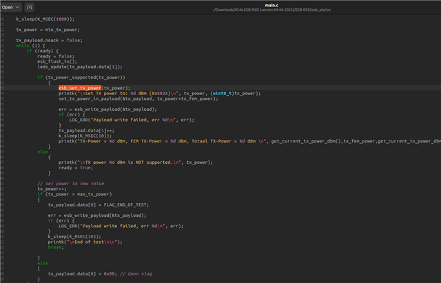

    Thank you for providing the sample projects. From the PTX project I see that you have implemented a function named tx_power_supported() which checks whether the requested output power is supported by the nRF RADIO. However, this does not apply when using the FEM, as the MPSL library will always attempt to achieve the requested output power by adjusting the RADIO TX gain, see TX power split.
    Vidar
  • Hi Vidar,
    thanks for your response. This is known to me — as you can see in my code, I add the FEM’s TX power also to the value. So I am taking that into total value. This is purely for reference, and I also include it in the ESB packet so that on the other side I can also see with which TX power value something was sent. But the main issue is that my RSSI value is lower when I activate MPSL.
  • This is the code I'm looking at:
    And as far as I can tell, the line esb_set_tx_power() will only be reached when txpower is set to a value supported by the RADIO.
  • I’m taking the radio TX power of the nRF5xxx and the nRF21xxx into account — you can see that I sum these values later on. This is the only way to calculate the total TX power. I’m using a loop to test various radio TX power levels. On the PRX side, you can then see which TX power is needed to send ESB packets reliably over a certain distance. So you can increase the distance and see which nRF configuration allows successful packet transmission. This works well and is stable.
    At the top of mail.c in the PRX example, you can also adjust the range within which you want to test. I’ve currently set it from 0 dBm to 10 dBm. I do check whether each TX power level can be used without causing errors during the test. For the FEM, I’m leaving the power at its default value in this demo, but it can be adjusted in fem.conf.
    My point is that the range becomes worse when using an nRF21540, even though it’s supposed to improve the range. The actual TX power I calculate isn’t that important — the key issue is which packets actually arrive at the PRX. And that’s a real problem when I activate the nRF21540 FEM — both with the nRF21540-EK and the nRF21540-DK.
    With the example I attached, you can clearly see this.
    Now the question is: am I doing something wrong in how I control the nRF21540? Is there something off in the Nordic Connect SDK 3.0? Or am I dealing with multiple faulty Nordic development boards?
    Thanks in advance for your response,

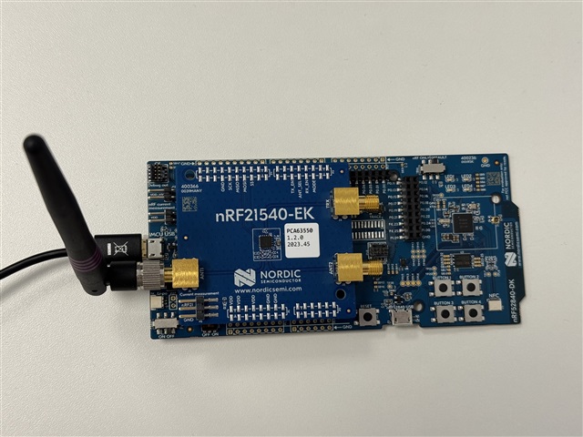

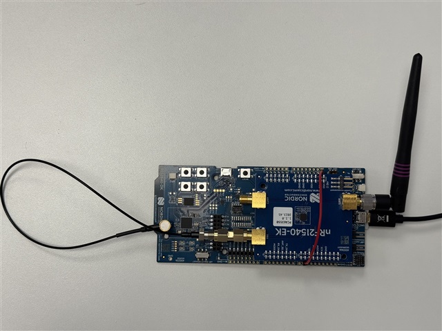

    Q2: Could you send a picture of the actual PTX and PRX boards and setup you are using?

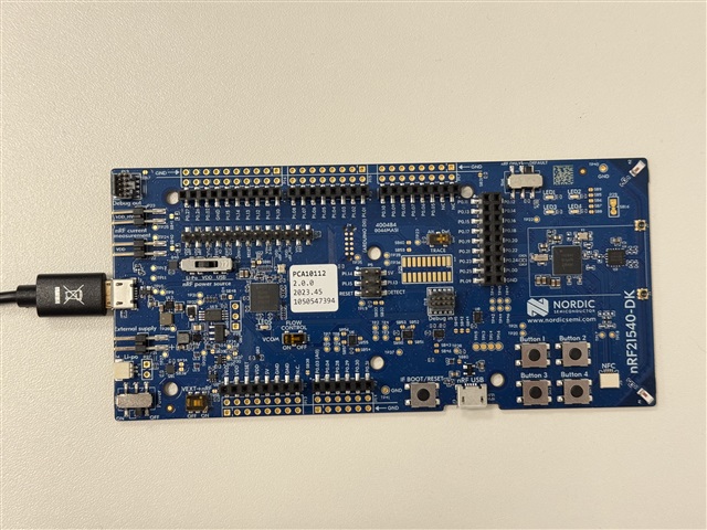

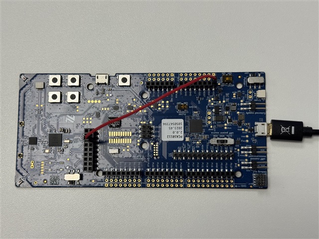

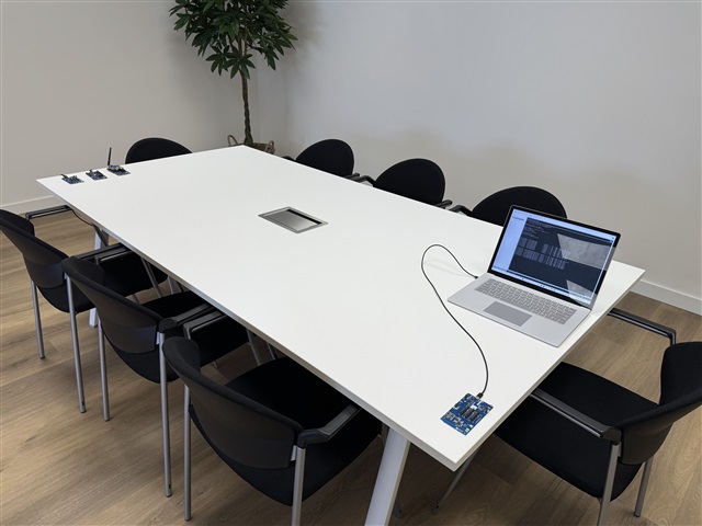

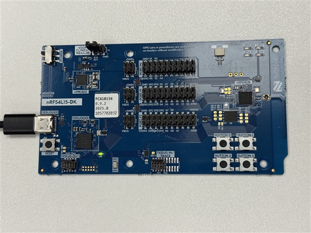

  • Dear Asbjørn,
    Sorry for my late reply — I was abroad for a while. Today I took some time to make a few photos of the test setup.
    Here are the answers to your questions:
    Q1: The firmware without FEM works fine.
    Q2: I've taken several photos of the test setup — see attachments.
    Q3: I have about 20 Nordic boards here, so I can try all possible combinations. I flash the firmware specifically for each configuration. So, in the case of an nRF52840-DK + nRF21540-EK, I enable FEM support in my build. I also see during the build that the nRF21540-EK is detected/activated. However, an nRF52840-DK has much better range without the external nRF21540-EK than with it. The same problem occurs when I attach the nRF21540-EK to an nRF5340-DK or an nRF7002-DK.
    For the nRF21540-DK, the range is so poor that the nRF21540-DK only works when I physically hold it right next to another board.

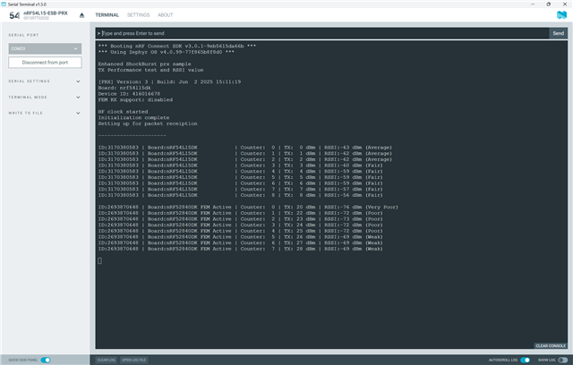

    Q4: To ensure a fair comparison, I test all boards at exactly the same distance. I’ve created test setups at 2m, 5m, and 10m distance. On the PRX side, I log all values so I can compare them easily afterward. For all tests, I now always use the same board on the PRX side — in this case, an nRF54L15-DK. I also tried with an nRF21540, but that didn’t help either and only made the tests more complicated. I’ve tried to keep the setup as simple as possible in order to present clear cases to Nordic Support.
    Eventually, I also want to equip the PRX with an nRF21540 chip, but that’s the next step — first, I just want to get this part working.
    I hope the answers and photos give you a better idea of my test environment. I also hope you’ll have some answers for us soon. We’re currently experiencing significant delays in our project, and at this point, that’s really no longer acceptable. I believe my colleague and I are quite experienced in software development and the Nordic ecosystem — we’re not beginners — and everything else in our project is running smoothly.

    *** Booting nRF Connect SDK v3.0.1-9eb5615da66b ***
    *** Using Zephyr OS v4.0.99-77f865b8f8d0 ***
    Enhanced ShockBurst prx sample
    TX Performance test and RSSI value
    [PRX] Version: 3 | Build: Jun  2 2025 15:11:19
    Board: nrf54l15dk
    Device ID: 416016678
    FEM RX support: disabled
    HF clock started
    Initialization complete
    Setting up for packet receiption
    ID:2693870648 | Board:nRF52840DK            | Counter:  0 | TX:  0 dBm | RSSI:-70 dBm (Weak)
    ID:2693870648 | Board:nRF52840DK            | Counter:  1 | TX:  2 dBm | RSSI:-67 dBm (Weak)
    ID:2693870648 | Board:nRF52840DK            | Counter:  2 | TX:  3 dBm | RSSI:-66 dBm (Weak)
    ID:2693870648 | Board:nRF52840DK            | Counter:  3 | TX:  4 dBm | RSSI:-65 dBm (Average)
    ID:2693870648 | Board:nRF52840DK            | Counter:  4 | TX:  5 dBm | RSSI:-65 dBm (Average)
    ID:2693870648 | Board:nRF52840DK            | Counter:  5 | TX:  6 dBm | RSSI:-65 dBm (Average)
    ID:2693870648 | Board:nRF52840DK            | Counter:  6 | TX:  7 dBm | RSSI:-64 dBm (Average)
    ID:2693870648 | Board:nRF52840DK            | Counter:  7 | TX:  8 dBm | RSSI:-62 dBm (Average)
    ID:2693870648 | Board:nRF52840DK FEM Active | Counter:  0 | TX: 20 dBm | RSSI:-83 dBm (Critical)
    ID:2693870648 | Board:nRF52840DK FEM Active | Counter:  1 | TX: 22 dBm | RSSI:-79 dBm (Very Poor)
    ID:2693870648 | Board:nRF52840DK FEM Active | Counter:  2 | TX: 23 dBm | RSSI:-79 dBm (Very Poor)
    ID:2693870648 | Board:nRF52840DK FEM Active | Counter:  3 | TX: 24 dBm | RSSI:-79 dBm (Very Poor)
    ID:2693870648 | Board:nRF52840DK FEM Active | Counter:  4 | TX: 25 dBm | RSSI:-79 dBm (Very Poor)
    ID:2693870648 | Board:nRF52840DK FEM Active | Counter:  5 | TX: 26 dBm | RSSI:-76 dBm (Very Poor)
    ID:2693870648 | Board:nRF52840DK FEM Active | Counter:  6 | TX: 27 dBm | RSSI:-76 dBm (Very Poor)
    ID:2693870648 | Board:nRF52840DK FEM Active | Counter:  7 | TX: 28 dBm | RSSI:-76 dBm (Very Poor)

  • Hello Herke,
    I would agree with you that the information related to the nRF21540 EK is scattered, in some aspects I think we could say the same about all Nordic documentation. It's not perfect and there's room for improvement.
    However, on the pictures I noticed something, and I might be seeing the incorrectly, but the output from the nRF52840-DK that you have plugged the nRF21540 onto doesn't seem to be connected. There should be a cable between J1 on the nRF52840-DK and the TRX SMA connector on the nRF21540-EK.
    Connector on the nRF52840 is a female type of MM8130-2600 connector onto the male SMA on the EK.
    Best regards
    Asbjørn
  • Hi Asbjørn,
    Thank you for your response. I’m not sure whether I should feel relieved or completely frustrated. At the very least, I really appreciate your comment.
    I’ve been struggling with the nRF21540 for two months now. I’ve already submitted multiple Q&A posts on this topic. At some point, I really started to lose hope. I work with the Nordic platform every day and feel like I have a pretty good grasp on it, but not being able to get the nRF21540 working has been incredibly frustrating. The cable doesn’t solve the issue I’m also experiencing with the nRF21540-DK — that board has a range of just 5 cm (not a typo).
    I went through all the Nordic documentation again, including every relevant webpage I could find. Nowhere is it mentioned that you need to bridge the J1 port. I assumed that was only used for lab equipment, like when testing output power with a spectrum analyzer. It’s honestly bizarre that this isn’t documented anywhere. There’s even a schematic showing which pins to enable and which ports to use — but still, no mention of this. Why isn’t there a simple diagram showing how to connect this cable, or a sentence in the text like: "Warning️ Warning: A connection is required between your development board (J1) and this port to include the FEM in your RF path." Why doesn’t Nordic include the cable in the kit? You always need it, and the type of cable is quite specific. Yet even that isn’t documented anywhere.
    I’ve now ordered the cable as well as an additional nRF21540-DB kit so I can also check whether the one I already have(nRF21540-DK) might be defective (max range 5 cm).

  • Hi Asbjørn,
    I ordered an MXHS83QE3000 cable from Mouser, along with an ADP-SMAM-SMAM-G RF adapter. I couldn’t find another cable with a male SMA connector. I also ordered an extra nRF21540-DB Kit to rule out the possibility of a defective development board. I received the items from Mouser yesterday.
    Today, I tested the setup using the cable between an nRF52840-DK and an nRF21540-EK. Unfortunately, the tests show no improvement compared to last week. I still observe around 10 dBm worse reception (my RSSI value is 10 dBm lower) compared to a standard nRF52840-DK board without a FEM.
    As soon as I disable the MPSL driver, the reception immediately improves, and the values return to those seen in the standard nRF52840-DK setup.
    As far as I can tell, the cable is connected correctly. See attached photo.
    I also tested with a standard nRF21540-DK board, of which I now received a second one. On this board as well, the reception is so poor that I can only transmit ESB packets when the boards are just a few centimeters apart.
    Working solution:
    I continued testing and checked the pin connections between the nRF52840-DK and the nRF21540-EK. It turned out that the PDN pin was never activated, although it should be, as far as I understand. When I manually forced the PDN pin high by connecting it to VDD, I achieved good TX power on the spectrum analyzer. The RSSI value in my ESB example is now 25 dBm higher.
    I did the same on the nRF21540-DK, where I previously had almost no output. After also forcing the PDN pin high on that board, it started working properly and I had very good reception on the PRX side.
    Conclusion:
    The current workaround is to manually force the PDN pin high by connecting it to VDD. However, this is not a proper solution. I assume the hardware is functioning correctly, and—as I have been pointing out for over six months through multiple support requests—this confirms that there is indeed a bug in the Nordic Connect SDK versions 2.8.0, 2.9.0, and later.
    Tip:
    I recommend updating the documentation to clearly state that an additional cable is required to connect the nRF21540-EK. I also strongly suggest including this cable in the box by default, as it is quite difficult to find the correct one online. If you choose not to include a cable, please at least specify the exact type needed (brand and part number).
    Question:
    Can Nordic fix this bug in the Nordic Connect SDK as soon as possible?
    Thanks in advance,
    Herke Dekker
    Photo 1: nRF52840-DK + nRF21540-EK (with wire connecting PDN to VDD)
    Photo 2: nRF21540-DK (with wire connecting PDN to VDD)
  • Hello Herke,
    Based on your experiences there will be an update to the nRF21540-EK out shortly with better figure and the part number for the cable that is needed.
    Regarding the PDN bug, I will try to recreate this observation here and report it to our development team as a bug. It should certainly be corrected and not sure how it could have gone undetected for a few SDK releases.
    Thank you for your feedback and I hope the evaluation goes better from here on out. I'll let you know when the update to SDK would be scheduled if you are interested.
    Best regards
    Asbjørn
