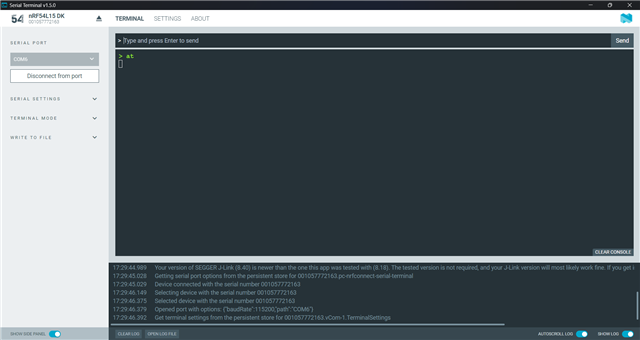

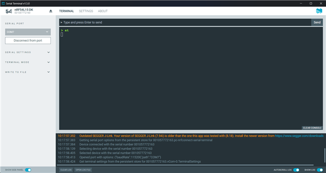

Q3: If I want to use nRF54L15-DK to read "RSSI", what I need to prepare?
Q4:Seriel Terminal can use any prompt? I command 'at' but no anyt respones

Benson_Lai said:Q4:Seriel Terminal can use any prompt? I command 'at' but no anyt respones
The serial terminal simply connects to the board with a UART connection. It doesn't necessarily provide a console, command line interface or similar. If the application running on the nRF logs to UART, for instance, then you will get that log. None of the BLE samples implements AT commands, but there is a serial application which can be used to control most aspects of BLE called Bluetooth Shell, which is found in nRF Connect SDK under \zephyr\tests\bluetooth\shell. It does not however provide commands for reading RSSI, from what I can tell.
