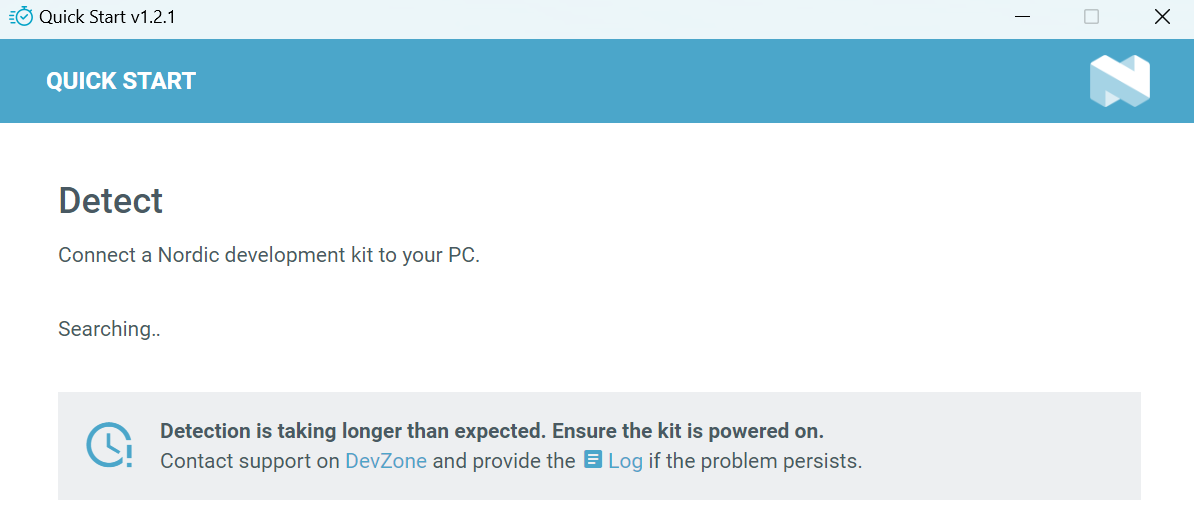

nrf connect for desktop can not detect nrf52840 dongle
I couldn't grab BLE 2M packets using wireshark and nrf52840 dongle, so I switched to using  the nRF connect for desktop. But it can not detect the dongle.
The nRF connect for desktop version is v5.2.0. The linetool and the jlink version as shown.

The application quick start log as shown.
2025-06-05T03:39:20.426Z INFO Initialising the bundled nrfutil device
2025-06-05T03:39:20.476Z DEBUG Started watching devices
2025-06-05T03:39:22.249Z INFO Using the bundled core version for nrfutil device: 8.0.0
2025-06-05T03:39:22.301Z INFO Using nrfutil-device version: 2.10.2
2025-06-05T03:39:22.301Z INFO Using nrf-device-lib version: 0.17.71
2025-06-05T03:39:22.301Z INFO Using nrf-probe version: 0.38.0
2025-06-05T03:39:22.301Z INFO Using JLink version: JLink_V8.18

    The Quick Start app doesn't work with the nRF52840 dongle, unfortunately. This is why it doesn't pop up when you open that app.
