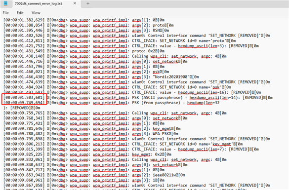

1.5340tfm jump to application taks about 8 seconds, why it takes so much time?
2.7002dk could never connect to Asus router once it is disconnected.(pc and mobile phone don't have such problem)
i have input the debug log in attachment, please help to look at this problem.
7607.7002dk_connect_error_log.txt
    Looks like there's a secure side log on timestamp at 1 and 9, so why do you mean that this is tfm?
    It is too little info for me to state anything on what happens in this scenario, unfortunately.

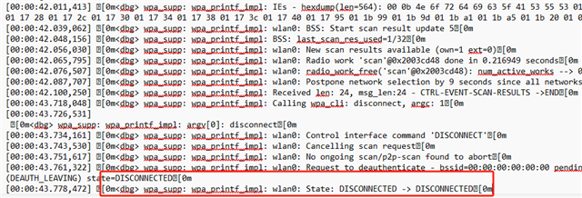

    Do you see the same issue if you use wifi/shell for instance?

  • Thanks Hakon,
    for problem 1, sorry for whatever i thought it was, it costs 8 to 9 seconds anyway.how can we reduce this time, it is not acceptable.
    this is mqtt demo by defualt.
    for problem 2, what should i do to collect more information if you need it?
    for problem 3, it is clear.
    William.

    I believe the issue you are seeing with the log is because the wifi thread is scanning and actively trying to connect, and thus blocking the log thread from running.
    By adding CONFIG_LOG_MODE_IMMEDIATE=y to the prj.conf file, you can see that the application is effectively blocked due to this scan/connect procedure:

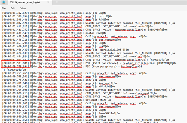

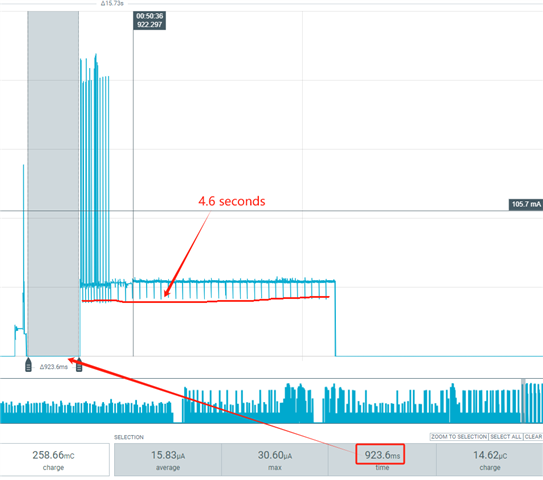

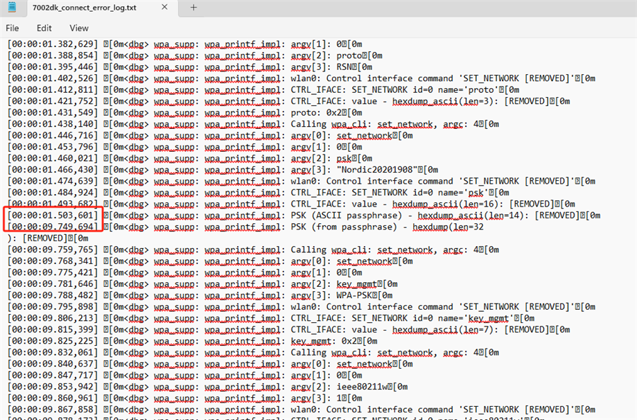

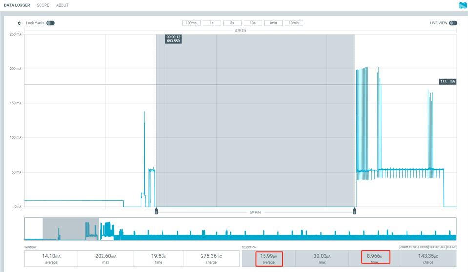

  • hi Hakon,
    i don't think it is related to this config: CONFIG_LOG_MODE_IMMEDIATE=y
    1.
    scan and connect wouldn't cost so much time, normally4-5 seconds, but you see it costs 15 seconds in your log.
    "Network connectivity established" costs 15 seconds, is because there is 8 to 9 seconds we blocked somewhere, we can see the current is 15uA.
    to prove my point of view, i change this config in boards/nrf7002dk_nrf5340_cpuapp_ns.conf
    CONFIG_WIFI_NM_WPA_SUPPLICANT_LOG_LEVEL_DBG=y
    # CONFIG_WIFI_NM_WPA_SUPPLICANT_LOG_LEVEL_ERR=y
    and i can't see any log here
    2.
    for another demo SHELL. connect to network costs 8 seconds.
    here is the log from shell:
    from "[11:05:56.514]wifi connect -s Nordic_ASUS -k 1 -p Nordic20201908"
    to "11:06:04.785 Connected", it costs only 8 seconds.
    11:05:53.355] [00:00:00.448,730] <inf> wifi_nrf: Configuring SLEEP CTRL GPIO control register
    [11:05:53.355]
    [11:05:53.355] uart:~$ *** Booting nRF Connect SDK v3.0.0-3bfc46578e42 ***
    [11:05:53.365] uart:~$ *** Using Zephyr OS v4.0.99-3e0ce7636fa6 ***
    [11:05:53.375] uart:~$ Starting nrf7002dk with CPU frequency: 128 MHz
    [11:05:53.375] uart:~$ [00:00:00.593,139] <inf> net_config: Initializing network
    [11:05:53.385] uart:~$ [00:00:00.593,139] <inf> net_config: Waiting interface 1 (0x2000d2d0) to be up...
    [11:05:53.396] uart:~$ [00:00:00.593,719] <inf> wifi_supplicant: wpa_supplicant initialized
    [11:05:53.404] uart:~$ uart:~$
    [11:05:56.514] wifi connect -s Nordic_ASUS -k 1 -p Nordic20201908
    [11:05:56.520] wifi connect -s Nordic_ASUS -k 1 -p Nordic20201908
    [11:05:56.520]
    [11:06:00.477] Connection requested
    [11:06:00.477] uart:~$
    [11:06:04.785] Connected
    [11:06:04.785] uart:~$ [00:00:12.477,600] <inf> wpa_supp: wlan0: SME: Trying to authenticate with 04:42:1a:a2:fc:74 (SSID='Nordic_ASUS' freq=5745 MHz)
    [11:06:04.814] uart:~$ [00:00:12.843,048] <inf> wpa_supp: wlan0: Trying to associate with 04:42:1a:a2:fc:74 (SSID='Nordic_ASUS' freq=5745 MHz)
    [11:06:04.824] uart:~$ [00:00:12.855,102] <inf> net_config: Interface 1 (0x2000d2d0) coming up
    [11:06:04.834] uart:~$ [00:00:12.858,978] <inf> net_config: IPv4 address: 192.168.50.98
    [11:06:04.844] uart:~$ [00:00:12.859,008] <inf> net_config: Running dhcpv4 client...
    [11:06:04.854] uart:~$ [00:00:12.861,572] <inf> wpa_supp: wlan0: Associated with 04:42:1a:a2:fc:74
    [11:06:04.864] uart:~$ [00:00:12.862,274] <inf> wpa_supp: wlan0: CTRL-EVENT-SUBNET-STATUS-UPDATE status=0
    [11:06:04.874] uart:~$ [00:00:12.882,171] <inf> wpa_supp: wlan0: WPA: Key negotiation completed with 04:42:1a:a2:fc:74 [PTK=CCMP GTK=CCMP]
    [11:06:04.885] uart:~$ [00:00:12.882,385] <inf> wpa_supp: wlan0: CTRL-EVENT-CONNECTED - Connection to 04:42:1a:a2:fc:74 completed [id=0 id_str=]
    [11:06:04.894] uart:~$ [00:00:12.895,812] <inf> net_dhcpv4: Received: 192.168.50.29
    [11:06:04.904] uart:~$ [00:00:12.895,904] <inf> net_config: IPv4 address: 192.168.50.29
    [11:06:04.912] uart:~$ [00:00:12.895,904] <inf> net_config: Lease time: 86400 seconds
    [11:06:04.924] uart:~$ [00:00:12.895,935] <inf> net_config: Subnet: 255.255.255.0
    [11:06:04.935] uart:~$ [00:00:12.895,935] <inf> net_config: Router: 192.168.50.1
    [11:06:04.942] uart:~$ uart:~$ uart:~$
    3.for another demo scan:
    scan costs only4.6 seconds, and there is no block before scan:
    in other words, did find that mqtt demo is quite slow in wifi connection?
