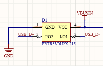

- The only additional connection to VBUS apart from the nPM1300 VBUS input is an ESD protection diode.

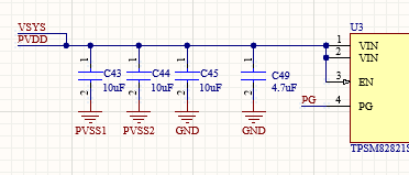

    - I've attached a screenshot of the schematic below. The three 10uF capacitors were implemented similar to the application example. However, I did add an additional 4.7uF capacitor to VSYS for an external buck regulator connected to the VSYS rail. Could it be this addition that is adding too much capacitance to VSYS?
    - The capacitance at VOUT1 and 2 are 10uF.

  • Hi
    So based on your new information,
    VBUS is collapsing, not VSYS:
    This indicates the power supply itself is shutting down/limiting, not the nPM1300's internal regulation.
    VBUS is an input for nPM1300. The only way it can make it collapse is pulling too much current on it compared to what it can deliver. However, when VBUS is at 2.00 V, then nPM1300 will not pull any current on it,  so it it stays at 2.00V it is not because nPM1300 pulls current.
    So the problem appears to be upstream of the nPM1300, not within it.
    Could there be a possible short or excessive loading somewhere in the circuit draw curremnt from VBUS?
    Or issue with PSU ?
    Also,
    Disabling DCDCs didn't help:
    Rules out excessive DCDC inrush current as the root cause
    Bypass test failed:
    Pre-charging capacitors via VBUS-VSYS short didn't create lasting fix ,confirms it's not just a startup transient issue
    This extra 4.7 uF capacitance at VSYS looks reasonable and shouldn't cause the issue.

    - The only thing connected to VBUS is an ESD protection diode placed near the USB port.

  • Have you tried disconnecting the buck converter TPSM82821S you have in the schematic? Maybe it has too high inrush current at startup that will exceed the current limit.
  • I haven't tried yet because both the VSYS input and EN pin for the TPSM are hard to access, and I want to keep desoldering the entire module to the last resort. Could it be though that the inrush current for the buck is higher than a SYSREG output limit but not a Charger limit?
