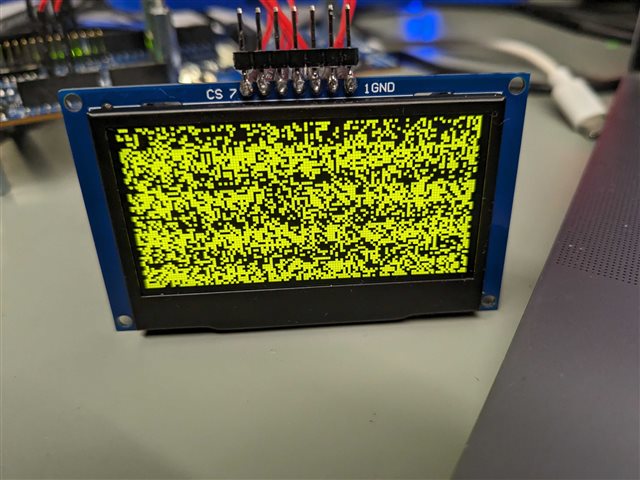

    Trying to get a Hello World app working using SSD1309 SPI OLED.
    Are there specific changes required to make a SSD1309_128x64 OLED work with the SSD1306 driver and glue code., to get the lvgl application running on the nrf5340DK?
    With the SSD1309 pins connected to PI.GPIO, the OLED display, powers up but is showing garbage. (attached pic)
    What is a recommended route to debug this further?
