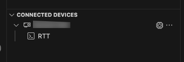

I just got the UICR_VREGHVOUT_VREGHVOUT_3V0 running and am wondering if that could be it. I used this post as a reference which identifies if it is at the right level otherwise sets it using:
NRF_UICR->VREGHVOUT = (UICR_VREGHVOUT_VREGHVOUT_3V3 | ~UICR_VREGHVOUT_VREGHVOUT_Msk);
It's not showing as connected like it normally does in vs code:
