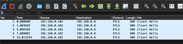

5) It seems that the COAP Client does not get a response at all to start a handshake, so I assume happens at connection level already, but can not tell what it is. So I think that the network stack does not even arrive to a step to check credentials at all.
Any suggestions, recommendations?
  • It seems that the COAP Client does not get a response at all to start a handshake
    The coap-client will need to start with the handshake even before sending the request. That may be be done internally in the coap-client/dtls mapping.
    Are you able to get some captures? E.g. run the coap/dtls client on an PC with wireshark ?
  • well, actually what I meant, was that not even handshake was possible, after the first "Client Hello" the nrf becomes non responsive.(non secure target)
    ❯ coap-client -v 7 -m get coaps://192.168.0.8/core1
    Jun 10 16:51:36.443 DEBG ***192.168.0.102:59711 <-> 192.168.0.8:5684 DTLS: new outgoing session
    Jun 10 16:51:36.444 DEBG *  192.168.0.102:59711 <-> 192.168.0.8:5684 DTLS: netif: sent  258 bytes
    Jun 10 16:51:36.444 DEBG timeout is set to 90 seconds
    Jun 10 16:51:36.444 DEBG sending CoAP request:
    Jun 10 16:51:36.444 DEBG ** 192.168.0.102:59711 <-> 192.168.0.8:5684 DTLS: mid=0x64d7: delayed
    Jun 10 16:51:37.448 DEBG ** 192.168.0.102:59711 <-> 192.168.0.8:5684 DTLS: DTLS retransmit timeout
    Jun 10 16:51:37.448 DEBG *  192.168.0.102:59711 <-> 192.168.0.8:5684 DTLS: netif: sent  258 bytes
    Jun 10 16:51:39.450 DEBG ** 192.168.0.102:59711 <-> 192.168.0.8:5684 DTLS: DTLS retransmit timeout
    Jun 10 16:51:39.451 DEBG *  192.168.0.102:59711 <-> 192.168.0.8:5684 DTLS: netif: sent  258 bytes
    Jun 10 16:51:43.452 DEBG ** 192.168.0.102:59711 <-> 192.168.0.8:5684 DTLS: DTLS retransmit timeout
    Jun 10 16:51:43.452 DEBG *  192.168.0.102:59711 <-> 192.168.0.8:5684 DTLS: netif: sent  258 bytes
    Jun 10 16:51:51.457 DEBG ** 192.168.0.102:59711 <-> 192.168.0.8:5684 DTLS: DTLS retransmit timeout
    Jun 10 16:51:51.457 DEBG *  192.168.0.102:59711 <-> 192.168.0.8:5684 DTLS: netif: sent  258 bytes
    Jun 10 16:52:07.459 DEBG ** 192.168.0.102:59711 <-> 192.168.0.8:5684 DTLS: DTLS retransmit timeout
    Jun 10 16:52:07.459 DEBG ** 192.168.0.102:59711 <-> 192.168.0.8:5684 DTLS: mid=0x64d7: not transmitted after disconnect
    Jun 10 16:52:07.459 ERR  cannot send CoAP pdu
    Jun 10 16:52:07.459 DEBG ***192.168.0.102:59711 <-> 192.168.0.8:5684 DTLS: session disconnected (COAP_NACK_TLS_FAILED)
    Jun 10 16:52:07.459 DEBG ***EVENT: COAP_EVENT_DTLS_CLOSED
    ^CJun 10 16:52:36.129 DEBG ***192.168.0.102:59711 <-> 192.168.0.8:5684 DTLS: session 0x1431078e0: closed

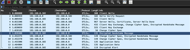

    but in contrast, lets say if I do it with the secure target, then it works as expected.
    Jun 10 16:40:12.006 DEBG ***192.168.0.102:60602 <-> 192.168.0.8:5684 DTLS: new outgoing session
    Jun 10 16:40:12.006 DEBG *  192.168.0.102:60602 <-> 192.168.0.8:5684 DTLS: netif: sent  258 bytes
    Jun 10 16:40:12.006 DEBG timeout is set to 90 seconds
    Jun 10 16:40:12.006 DEBG sending CoAP request:
    Jun 10 16:40:12.006 DEBG ** 192.168.0.102:60602 <-> 192.168.0.8:5684 DTLS: mid=0x1648: delayed
    Jun 10 16:40:12.021 DEBG *  192.168.0.102:60602 <-> 192.168.0.8:5684 DTLS: netif: recv   60 bytes
    Jun 10 16:40:12.022 DEBG *  192.168.0.102:60602 <-> 192.168.0.8:5684 DTLS: netif: sent  290 bytes
    Jun 10 16:40:12.034 DEBG *  192.168.0.102:60602 <-> 192.168.0.8:5684 DTLS: netif: recv  925 bytes
    Jun 10 16:40:12.035 INFO    192.168.0.102:60602 <-> 192.168.0.8:5684 DTLS: self-signed certificate: overridden: 'localhost' depth=0
    Jun 10 16:40:12.035 INFO    192.168.0.102:60602 <-> 192.168.0.8:5684 DTLS: unable to get certificate CRL: overridden: 'localhost' depth=0
    Jun 10 16:40:12.035 INFO CN 'localhost' presented by server (Certificate)
    Jun 10 16:40:12.035 DEBG *  192.168.0.102:60602 <-> 192.168.0.8:5684 DTLS: netif: sent  390 bytes
    Jun 10 16:40:13.040 DEBG ** 192.168.0.102:60602 <-> 192.168.0.8:5684 DTLS: DTLS retransmit timeout
    Jun 10 16:40:13.040 DEBG *  192.168.0.102:60602 <-> 192.168.0.8:5684 DTLS: netif: sent  283 bytes
    Jun 10 16:40:13.040 DEBG *  192.168.0.102:60602 <-> 192.168.0.8:5684 DTLS: netif: sent   14 bytes
    Jun 10 16:40:13.041 DEBG *  192.168.0.102:60602 <-> 192.168.0.8:5684 DTLS: netif: sent   93 bytes
    Jun 10 16:40:14.465 DEBG *  192.168.0.102:60602 <-> 192.168.0.8:5684 DTLS: netif: recv  107 bytes
    Jun 10 16:40:14.465 DEBG ***EVENT: COAP_EVENT_DTLS_CONNECTED
    Jun 10 16:40:14.465 DEBG ***192.168.0.102:60602 <-> 192.168.0.8:5684 DTLS: session connected
    Jun 10 16:40:14.465 DEBG ** 192.168.0.102:60602 <-> 192.168.0.8:5684 DTLS: mid=0x1648: transmitted after delay
    Jun 10 16:40:14.465 DEBG *  192.168.0.102:60602 <-> 192.168.0.8:5684 DTLS: netif: sent   93 bytes
    Jun 10 16:40:14.465 DEBG *  192.168.0.102:60602 <-> 192.168.0.8:5684 DTLS: dtls:  sent   17 bytes
    v:1 t:CON c:GET i:1648 {} [ Uri-Path:core1, Request-Tag:0xc9075556 ]
    Jun 10 16:40:14.466 DEBG ** 192.168.0.102:60602 <-> 192.168.0.8:5684 DTLS: mid=0x1648: added to retransmit queue (2844ms)
    Jun 10 16:40:14.466 DEBG *  192.168.0.102:60602 <-> 192.168.0.8:5684 DTLS: netif: recv  107 bytes
    Jun 10 16:40:14.477 DEBG *  192.168.0.102:60602 <-> 192.168.0.8:5684 DTLS: netif: recv   93 bytes
    v:1 t:ACK c:2.05 i:1648 {} [ ] :: 'Just a test\x0A\x00'
    Jun 10 16:40:14.477 DEBG ** 192.168.0.102:60602 <-> 192.168.0.8:5684 DTLS: mid=0x1648: removed (1)
    Jun 10 16:40:14.477 DEBG ** process incoming 2.05 response:
    Just a test
    Jun 10 16:40:14.477 DEBG *  192.168.0.102:60602 <-> 192.168.0.8:5684 DTLS: netif: sent   77 bytes
    Jun 10 16:40:14.477 INFO *  192.168.0.102:60602 <-> 192.168.0.8:5684 DTLS: SSL3 alert write:warning:close notify
    Jun 10 16:40:14.477 DEBG ***EVENT: COAP_EVENT_DTLS_CLOSED
    Jun 10 16:40:14.478 DEBG ***192.168.0.102:60602 <-> 192.168.0.8:5684 DTLS: session 0x158907e50: closed

    Jun 10 17:03:01.631 DEBG ** 192.168.0.102:49748 <-> 192.168.0.8:5685 DTLS: DTLS retransmit timeout
    Jun 10 17:03:01.632 DEBG *  192.168.0.102:49748 <-> 192.168.0.8:5685 DTLS: netif: sent  258 bytes
    Jun 10 17:03:01.637 WARN ** 192.168.0.102:49748 <-> 192.168.0.8:5685 DTLS: coap_socket_recv: ICMP: Connection refused
    Jun 10 17:03:01.637 DEBG ***192.168.0.102:49748 <-> 192.168.0.8:5685 DTLS: session ICMP issue (COAP_NACK_ICMP_ISSUE)
    Jun 10 17:03:09.636 DEBG ** 192.168.0.102:49748 <-> 192.168.0.8:5685 DTLS: DTLS retransmit timeout
    Jun 10 17:03:09.637 DEBG *  192.168.0.102:49748 <-> 192.168.0.8:5685 DTLS: netif: sent  258 bytes
    Jun 10 17:03:09.641 WARN ** 192.168.0.102:49748 <-> 192.168.0.8:5685 DTLS: coap_socket_recv: ICMP: Connection refused
    Jun 10 17:03:09.641 DEBG ***192.168.0.102:49748 <-> 192.168.0.8:5685 DTLS: session ICMP issue (COAP_NACK_ICMP_ISSUE)
    Jun 10 17:03:25.641 DEBG ** 192.168.0.102:49748 <-> 192.168.0.8:5685 DTLS: DTLS retransmit timeout
    Jun 10 17:03:25.642 DEBG ** 192.168.0.102:49748 <-> 192.168.0.8:5685 DTLS: mid=0x2729: not transmitted after disconnect
    Jun 10 17:03:25.642 ERR  cannot send CoAP pdu
    Jun 10 17:03:25.642 DEBG ***192.168.0.102:49748 <-> 192.168.0.8:5685 DTLS: session disconnected (COAP_NACK_TLS_FAILED)
    Jun 10 17:03:25.642 DEBG ***EVENT: COAP_EVENT_DTLS_CLOSED
    ^CJun 10 17:03:34.344 DEBG ***192.168.0.102:49748 <-> 192.168.0.8:5685 DTLS: session 0x122007ac0: closed
  • My suspicion, is that coap server stack implementation, which was adapted on zephyr's main line in order to support DTLS, may not be compatible to NS/TFM yet, and hopefully is adapted soon to be integrated in the NCS. Am I right?
  • I'm no employee of Nordic. I guess, that DTLS calls some crypto-function from NS, which are not supported to be called from that. But that's just a guess.
