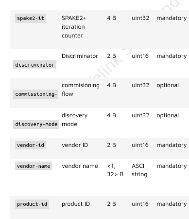

What I mean is the configuration, which could be factory data or the prj.conf settings.
As shown in the image below
0:Standard, 1:User-Intent, 2:Custom.
I'm using Nordic's generate_nrfconnect_chip_factory_data.py to generate the QR code, so does that mean this Python script can't change the Commission Flow?
Of course you can change the Commissioning Flow inside QR code using Python script. Here is the variable: https://github.com/nrfconnect/sdk-connectedhomeip/blob/d56ca73159fd5973d839b14714f0a08b9695d4a8/scripts/tools/nrfconnect/generate_nrfconnect_chip_factory_data.py#L425
Thank you for your assistance
I discovered another issue. Modifying the "generate_nrfconnect_chip_factory_data.py" script only affects the files generated by Python, such as build.txt. However, the QR code printed by the firmware during boot-up (i.e., [SVR]SetupQRCode) remains unchanged. After tracing through the SDK, I found that this value is hardcoded. Is there a way to modify it without changing the SDK itself?
