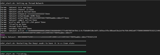

1. setup OTBR on Pi4:./certification-tool/backend/test_collections/matter/scripts/OTBR/otbr_start.sh

3. run  TC-DGGEN-2.1, but auto commission fail. (nordic52840 factory reset before run case) , log refer to below file.
UI_Test_Run_2025_06_11_10_51_25.log
  • after commission fail, I input below cmd:
    docker exec -it otbr-chip bash
    root@ubunbtu:/app# ot-ctl state
    connect session failed: Connection refused (error info)
    but it display like this before I run this case. Why?
    leader
    Done

  • Hi chew_moon_cake,
    Could you please provide more details?
    We need to have logs from border router to check what "not properly" started.
    If the Border Router (BR) is started by the Test harness, you can check if the srp server is running on the Border Router with:
    docker exec -ti <otbr_container> ot-ctl srp server state
    If the srp server is not running, you can enable it with:
    docker exec -ti <otbr_container> ot-ctl srp server enable
    If the Border Router is not started by the Test Harness, you can start it on your own.
    For example, you can start it with the script in certification-tool/backend/test_collections/matter/scripts/OTBR/.
    If the Border Router is on a separated device from the Test Harness, that also works.
    On the Border Router, you need to get the dataset hex with
    dataset active -x
    Then please set the dataset hex in the project config in the Test Harness at these locations:
    "test_parameters": {
        "thread-dataset-hex":  <output_of_dataset_active_x>
    and
    "thread": {
        "operational_dataset_hex": <output_of_dataset_active_x>
    Hieu
