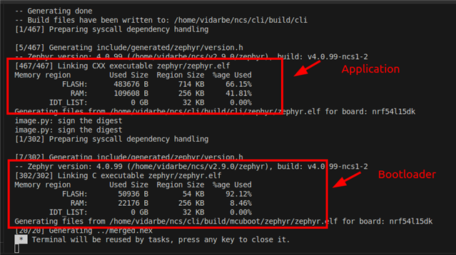

    Thanks for your insights. I was wondering if you could elaborate on how to shrink the app size? In the link you gave above, you talked about creating a sysbuild/mcuboot directory with a prj.conf file. You provided the conf file as well and I have included that in the directory.
    However, it seems like creating a new build with this new prj.conf file included doesn't seem to shrink my project size.
    Currently, I'm testing for the changes in partitions.yml with the given CLI sample from the SDK. I was wondering why does such a minimal project like CLI take up SO MUCH space, such that it is not possible for DFU? Below is the partitions.yml for the CLI sample, this should be reproducible on your guys' end as well. I am using the 54l15dk

    Please look at the build output to see the actual size of your application. This is not the same as the size you have allocated the app partition.  For comparison this is what I get when I build the same sample from SDK v3.0.2 with SB_CONFIG_BOOTLOADER_MCUBOOT=y
    Build output
    Generated partitions.yml
