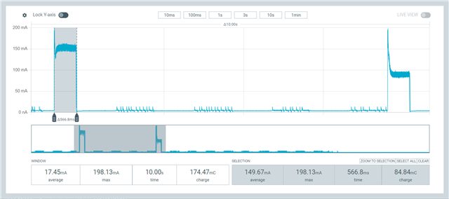

    I don't have any voltage measurements from before.
    Now, when set Source mode 3000mV, the actual voltage measured was 2.422V

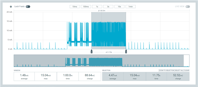

    This device does not exceed around 15mA consumption in normal state.
    The ppk2 is unable to supply this motor operation which demand 200mA (old measurement)
    Everything is the same, except the power profiler was updated to v4.2.2.
    However I also tested an v4.2.1 and there is no changes.
    So, where it previously was able to deliver up to 200 mA, it is now only able to deliver 15 mA?
