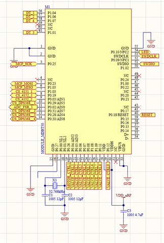

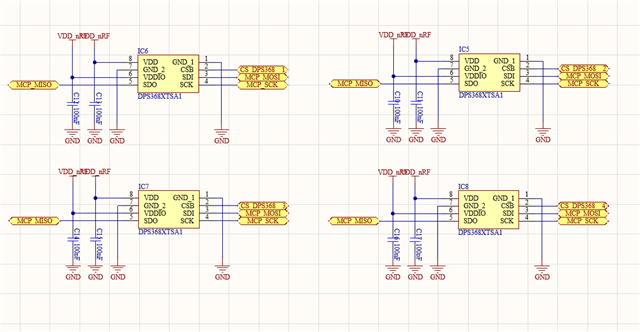

I am trying to use the DPS368XTSA1 sensor with the nRF52833 via SPI.
First, I’m attempting to read the sensor’s ID during initialization, but it’s not being read properly.
Could you help identify what might be wrong?
When executing the dps_init() function from main, a read command is sent to register 0x0D, which should return the PRODUCT ID 0x10, but no valid response is received.

  • Obvious issue to start with. At 8MHz high-drive (H0H1) is required on SPIM output pins, not standard drive (default S0S1). Fix by boosting drive to H0H1 after the function nrf_drv_spi_init():
        // Set High-drive pin mode for SPIM at 8MHz
        nrf_gpio_cfg(PIN_SCK,  NRF_GPIO_PIN_DIR_OUTPUT, NRF_GPIO_PIN_INPUT_CONNECT, NRF_GPIO_PIN_NOPULL, NRF_GPIO_PIN_H0H1, NRF_GPIO_PIN_NOSENSE);
        nrf_gpio_cfg(PIN_MOSI, NRF_GPIO_PIN_DIR_OUTPUT, NRF_GPIO_PIN_INPUT_CONNECT, NRF_GPIO_PIN_NOPULL, NRF_GPIO_PIN_H0H1, NRF_GPIO_PIN_NOSENSE);
        nrf_gpio_cfg(PIN_CS,   NRF_GPIO_PIN_DIR_OUTPUT, NRF_GPIO_PIN_INPUT_CONNECT, NRF_GPIO_PIN_NOPULL, NRF_GPIO_PIN_H0H1, NRF_GPIO_PIN_NOSENSE);
    Test if still not working by doing a loop-back; if possible isolate MISO pin by disconnecting it and connect to MOSI. The received Rx should be the same as the transmitted Tx. (A software loopback is possible but more complex).
    Loopback or 3-wire SPIM see my notes: nrf52840-3-wire-spi-using-sdk
    What did nrf_drv_spi_init() return? Success?
    Have you tried scoping the SPI GPIOs using a logic analyzer? Do you see data on the MOSI? And the MISO? And if you scope close to the nRF, and close to the sensor, does the signal look the same? Working with high speeds might be difficult if the wires/traces are long. As   says, you can try to enable high drive for the SPI GPIOs, to see if that helps, or reduce the length of the wires, or try with a lower speed.
    Another note: I see that you have peppered your application with NRF_LOG_FLUSH(); Please don't do that, as it may cause hardfaults to occur. If one NRF_LOG_FLUSH() is interrupted by another NRF_LOG_FLUSH, then it will crash. I don't see that you have it in any of your interupts, but since you seem to be quite generous in it's use, so I thought I would mention it.
