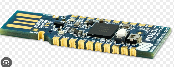

So I got me one of these
and after a day of making it work on windows I was able to lunch visual code from wsl and compile. the next day I found how to make a flash with nrfutil and was able to create a zip. So I pressed the button and the LED changed its blink rate, and I ran a few commands.
nrfutil keys generate private.key
nrfutil pkg generate --hw-version 52 --sd-req 0x00 --application nrf52832_xxaa.hex --application-version 1 --key-file private.key app_dfu_package.zip
nrfutil dfu serial -p COM5 -pkg app_dfu_package.zip -b 115200
I then got this
  [####################################]  100%
Device programmed.
now the device is dead. I tried holding down the button on insert and pressing after it was in. no USB chine no led. I flashed the gpiote example in hopes it woudl be a BT device that used GPIO pins, but it just make a brick.
Can this be fixed? If not, what did I do wrong?

  • You can solder a 10 pin header to the bottom of the dongle, then connect to an external debugger.
    For most development work I'd recommend a full development kit, it's not a great experience to use the dongle and use serial DFU vs. a full debugger.

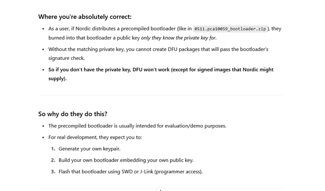

    My guess is that the bootloader fails to use an image with your own keys and dies before executing the application.

    Can I download a key that works with the bootloader? the firmware creation required I make one.

  • It's impossible to tell you what is wrong with the bootloader since you cannot get logs out of it on the dongle. If boot fails, no logs come through the USB-CDC ACM port. That's why my recommendation is to use a development kit to diagnose these issues, building for an nRF52840-DK target before moving to the dongle. You also appear to have flashed an nRF52832 image to an nRF52840 dongle.
    "nrfutil pkg generate --hw-version 52 --sd-req 0x00 --application nrf52832_xxaa.hex --application-version 1 --key-file private.key app_dfu_package.zip"
    Here is info on how to access the SWD pins on the dongle where it can be flashed with an MCUboot enabled application:
    https://docs.nordicsemi.com/bundle/ug_nrf52840_dongle/page/UG/nrf52840_Dongle/hw_swd_if.html
