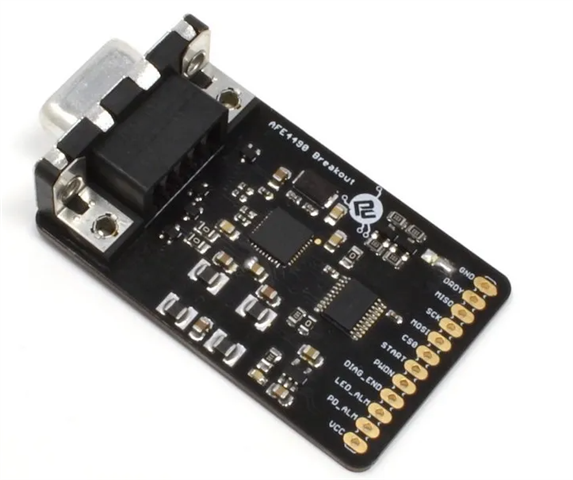

Hello community,
I have been recently working with AFE4490 sensor from protocentral (breakout board).
GitHub - Protocentral/protocentral-afe4490-arduino: Arduino Library for the AFE4490 SPO2 shield and breakout boards from Protocentral
Previously I have ported multiple sensors for my hobby projects and never faced any issue but I am not able to initialize the registers with this sensor in nrf52840.
Here are few things I trieD:
1. I evaluated this sensor with ESP32 C3 module and the sensor LED turns ON after succesful intialization.
2. Ported the C++ code base to nrf52840 SPI peripheral example code and description is mentioned below:
3. Used SPI pin as mentioned below:
#define AFE_MISO_PIN 30//24
#define AFE_MOSI_PIN 29//23
#define AFE_SCK_PIN 28//25
#define AFE_CS_Pin 31//22

Currently, I am more focused on register initialiozation. Once its success then I will proceed further with reading of SPo2 and heart rate values.
I am not sure where I am going wrong, I tried changing the modes to Mode 0,1,2,3 but nothing works. Its been a week now. Requesting somebody to help me on this.

    Attached the C file FYR. Attaching the sensor image below:
    Requesting some guidance in the earliest.
    Thank you.
    Thank you.
