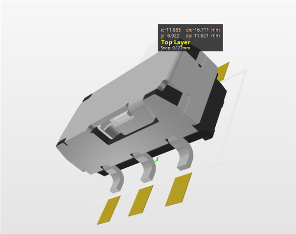

Footprint Problem with SW8 (MK-22D14-G2) on nRF7002 DK Board
I'm sure you know this already, but there seems to be a problem with the subject footprint. I guess I'm posting this to confirm that it in fact does have a bug in that the row spacing between pads is about 1mm to large. Here's the Altium 3D view and the datasheet for the switch corroborates this. Can you please confirm that this is a problem? When I look at the DK it looks like the legs on the part have been manually stretched out to be able to reach the pads. I can't get a clear zoomed picture with my phone.
