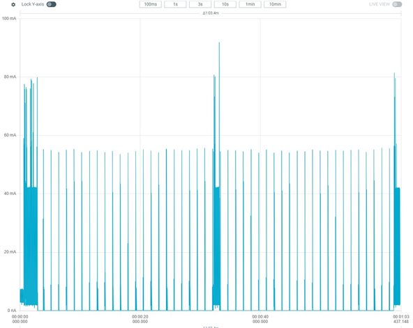

I am trying to measure nRF9151 current using Power Profiler Kit II, running Cellular UDP project on EVK and following the steps in:
https://docs.nordicsemi.com/bundle/ncs-latest/page/nrf/samples/cellular/udp/README.html
Added the following lines to prj.conf:
CONFIG_SERIAL=n
CONFIG_TFM_LOG_LEVEL_SILENCE=n
CONFIG_UDP_DATA_UPLOAD_FREQUENCY_SECONDS=30
It seems the modem doesn't enter PSM mode in the image below:
Thanks in advance for your comments and insight to help resolve this issue.
Roya
  • Hi Roya,
    Are you sure that you are requesting PSM, etc.?
    Could you try running eg. XMONITOR for me? There is a bit on this here and here.
    Elfving
  • Hi Elfving,
    My understanding was that running Cellular UDP sample project would be sufficient as a standalone code to check power consumption in PSM mode. PSM is already enabled with 60 min RPTAU, and I just need to configure the data upload size (default: 10) and upload frequency (e.g. 30 sec).

    - On your second question, please see below the result:
    > AT+CPSMS=1,,,"00101000","01000001"
    OK
    > AT+CPSMS?
    +CPSMS: 1,,,"00101000","01000001"
    OK
    > AT%XMONITOR
    %XMONITOR: 5,"","","302720","757B",7,12,"007A637A",101,5060,54,34,"","11100000","11100000","01001001"
    OK
    It seems the network has not enabled the requested PSM mode, is it correct?
    Thank you,
    Roya
  • I guess, there may just be more cellular network details to consider.
    PSM is a feature intended for sleeps about 1h and more.
    You send every 30s, right?
    Before the modem enters the sleeping mode, it must enter the IDLE mode. That either requires RAI (and proper applying it). If RAI is not used, the network defines a timeout to switch from RRC active to idle. And after that there is a "PSM active time", which also must pass, before the modem goes to sleep.
    But a 30s send interval doesn't fit PSM (except you want to kill your SIM). Let me recommend to check with your network provider, if eDRX is also offered, that's a much better choice for 30s.
    And finally:
    Sending every 30s drains your battery, regardless of eDRX or PSM ... maybe you do some calculations, which runtime would be expected sending every 30s with your values from above. Subtract the energy in the "inactive" periods, and you may see, if eDRX or PSM will really change your runtime.

    - It makes sense to use PSM for longer sleep intervals, 30 s was just for testing.
    - I will check it again with different network providers, if not generally supported may be turning off the modem for long intervals would be a solution.
    - Interesting note about setting LTE parameters, I guess setting directly in the code is better in low level development and setting by AT commands for applications such as SLM?
    Roya
  • - It makes sense to use PSM for longer sleep intervals, 30 s was just for testing.
    Let me recommend then, that you use something as 300s to see, if it then enters the psm sleep after a longer RRC active and idle period,
    PSM is widely support, but as I already wrote Spark NZ has used different base stations (1.5 years) ago, and it toke some month to have them fixed the old/broken ones in the test area. So, if you test, you will need to track the base-station and see, if the result depends on that. Hope this is now generally fixed, but you will see.
    If "switching on/off" helps is something you will also need to discuss with Spark NZ, some operators will block too frequently network registrations. But with 1h I guess you will be save.
