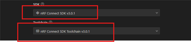

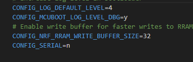

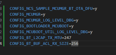

nrf54l15dk,v3.0.1,peripheral_uart demo and no changes have been made.
Then add the following content to prj.conf
sysbuild.conf
mcuboot.conf
Finally, use the OTA file under build to upgrade
Looking forward to your reply!

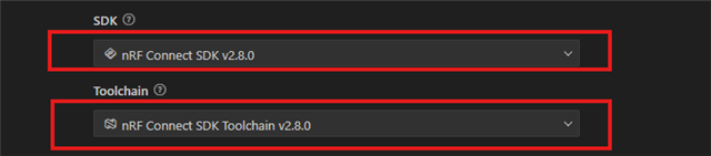

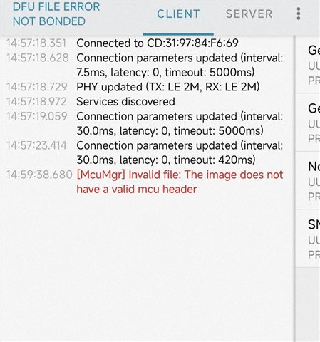

HI
According to the configuration in my question,I can run normally in 2.8.0, but according to the same configuration , the situation shown in the picture will appear in v3.0.1. From the information you provided, I don't see any difference between the two versions. Do you have any suggestions?
