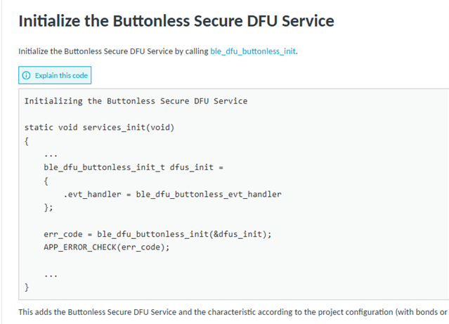

    This is what I understand at present the issue is. You need a firmware where the system only allows firmware updates after receiving a specific command. For this, ,aybe you can follow the Buttonless DFU sample in the nRF5 SDK. However, the issue is that here a BLE service allows a central device to trigger DFU mode at any time. Ifyou take a look at this https://docs.nordicsemi.com/bundle/nrf5_SDK_v17.1.1/page/service_dfu.html#secure_dfu_buttonless_app_init :
    Here, maybe you could try to execute that snippet, i.e.
    ble_dfu_buttonless_init_t dfus_init = {
    .evt_handler = ble_dfu_buttonless_evt_handler
    after a check to see if the required command to begin DFU was received. If so, go ahead and implement it.
