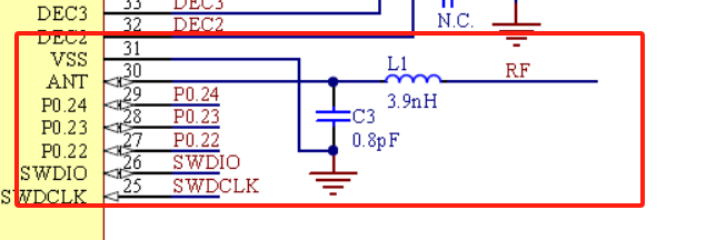

We are developing products using the NORDIC NRF54L series chips, but we are encountering some hardware issues.
We have used the NRF52832-QFAA chip. Packaged type:QFN48,Reference design is TWO-layers PCB,

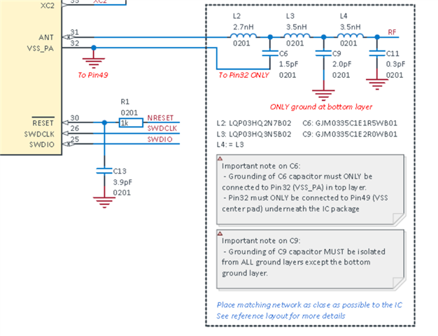

However, the NRF54L series, such as the NRF54L15-QFAA chip, Packaged type:QFN48, Reference design is FOUR-layers PCB.
1,Why did this design choose to use FOUR layers of PCB?
2,Since the overall structure of our product design is relatively thin, we would like to confirm whether the NRF54L series, QFN48, supports two-layer PCB ?
   Could you provide a reference design for the hardware?
3,RF section
Below is NRF52832-QFAA QFN48 RF section
Below is NRF54L series-QFAA QFN48 RF section
Would you like to know the reasons for the addition of new components in the RF section of the design? Was the design of the RF part for NRF52832-QFAA still applicable to NRF54L QFAA?
If possible, could the RF part of NRF54L be further streamlined to better meet practical application needs, such as: FIND MY, BLE UART?
