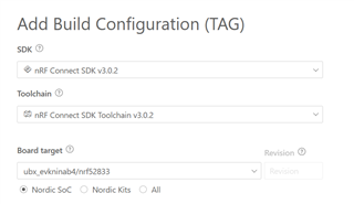

and opened it with VS IDE in which I have the nrf connect SDK installed by following your youtube nRF Connect for VS Code, part 1: Installation series .
As you can see I buit the configuration with the following settings:
When I build the code i have the following error in the terminal:

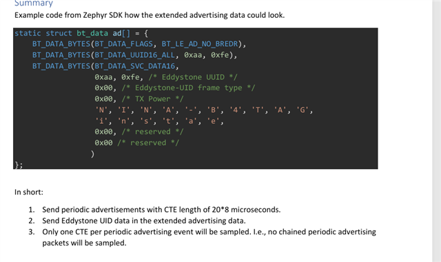

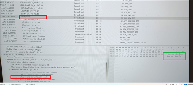

    I started with direction_finding_connectionless_tx by trying to send the CTE packet (so that I can also send the eddystone packet once done) from an nrf52833DK board. From the other side I tried with 2 Kind of sniffer:
    • nrf52840 USB dongle sniffer
    • another nrf52833DK  sniffer
    and by using wireshark I cant see any "CTE present=1".
    What its strange to me is that both sniffer see the TX like Anonymous device.
    I post the related info below
    Can you help us about this?
    Thanks a lot.
