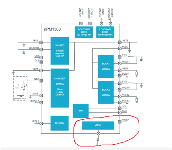

  • I am using the nRF5340, which is powered from BUCK2 of an nPM1300 PMIC. I also wanted to control power to both the nRF5340 and external sensors using an SPDT switch. The 3.3V from BUCK2 powers the main VDD as well as the VDDIO domain.
    I tried configuring the switch pin with a pull-up and also used it to control the BUCK converters (BUCK1 and BUCK2). When I turn off the SPDT switch, both the nRF5340 and the sensors are powered down — as expected. But I noticed a problem:
    When VDDIO also drops, the GPIO loses its configuration and the pull-up no longer holds the pin high. The behavior is not reliable:
    • Sometimes it works — the pin stays pulled up and the PMIC remains off
    • Other times it fails — the pin floats and the PMIC restarts
    Also, when I connect the J-Link debugger (just GND, SWD, NRST, SWCLK), sometimes both BUCK converters turn ON unexpectedly, even though I did not request them to. I don’t understand why this is happening.
    Am I correct in thinking this is due to the fact that the VDDIO domain powers the GPIO controller — so when VDDIO drops, the GPIO settings are lost? Or is there some other behavior with the nRF5340 + nPM1300 that I’m missing?
  • Hello Hamza,
    ''Am I correct in thinking this is due to the fact that the VDDIO domain powers the GPIO controller — so when VDDIO drops, the GPIO settings are lost? ''
    Yes, you are correct. When VDDIO drops, the GPIO controller on the nRF5340 (and also on the nPM1300) loses its configuration, including pull-up/pull-down settings.
    As VDDIO sources the GPIO pins. When VDDIO is not powered or removed, the GPIOs become undefined, and any internal pull-up or pull-down resistors are no longer active. So, pin can be in floating or high impedance state. That could trigger the occurring of unexpected behavior you are observing.
