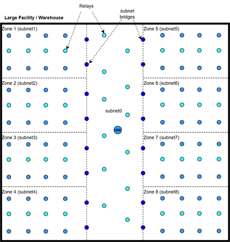

    • We are a leading manufacturer of EC fans integrated into energy-efficient HVAC systems. In cleanroom environments, we may deploy up to 1,000 EC fans connected via a mesh topology with a central gateway. Our implementation currently uses a vendor-specific model with a maximum payload of 80 bytes, with potential plans to scale up to 256 bytes. We believe that the MDF (Mesh Directed Forwarding) feature will significantly help in reducing network traffic in such high-density deployments.
    • Ok. Based on our estimations, MDF can provide some benefits (in some topologies) only if max-hops between sender and receiver are more than 5/6 hops. Otherwise MDF is not useful, it is more bloat than help. Note: MDF is not currently supported on our SDK. Our suggestion is to try to explore other techniques that could help to limit/isolate the traffic. example the Bluetooth® Mesh Subnet Bridging, which is already supported in nRF Connect SDK:  https://www.bluetooth.com/mesh-subnet-bridging/

    • 1000 nodes is quite possible with mesh but depends also on topology. Two things that will help getting performance right:
      A) reduce the number of relay nodes: you probably don't need all nodes to be relay. In our testing with 99 nodes, we cover two scenario: (a) All relays (b) Corridor nodes as relays. This will depend on how far nodes are from each other.  Large scale Bluetooth mesh testing
      B) if topology allows, you can take advantage of subnet to reduce/limit traffic:
      GW sends a message to destination N => Message propagates across the network and if it is sent to the bridged address, the bridge which knows that it had been configured to handle message destined for the address N, will then convert the network key and re-broadcast the message. The relays in that subnet then pick up this message and start relaying it.
      When destination N wants to send message to GW => Message propagates across the network and if it is sent to the bridged address, the bridge which knows that it had been configured to handle message destined for the address GW will then convert the network key and re-broadcast the message. The relays in that subnet then pick up this message and start relaying it.
      So, whole process happens transparently. Only during the network setup, the network configurator needs to configure subnet bridges and add appropriate SRC-DST pairs in the bridging table of the bridge.
      For the nodes, I would suggest to use nRF54L10 or nRF54L15, with dual bank dfu and using max Tx power. However final choice depends on many aspects outside Nordic control, including your application code/logics.
