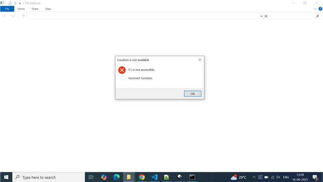

yaml file not generating partitions
this my yaml.file to use partition manager, beacause iam implementing DFU, USB MSC with fatfs in single project

and also iam getting disk failed , iam unable to access the usb mass storage drive
