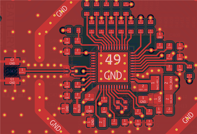

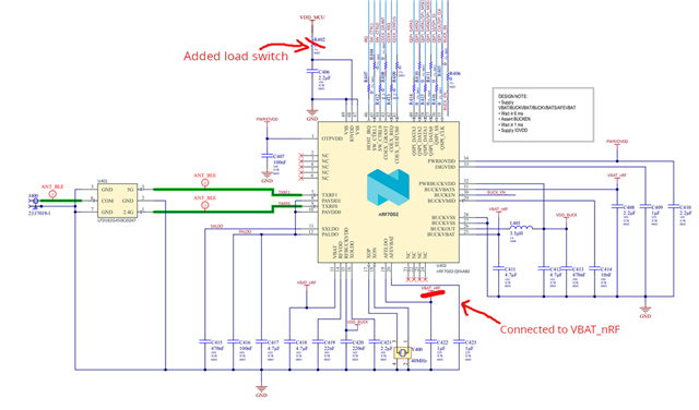

Initially, there were a few mistakes in the schematic, which I’ve since fixed (I also replaced the nRF7002 IC to eliminate any potential hardware damage from earlier mistakes). Now the Wi-Fi chip boots without errors, but the functionality is unstable:
  •     It can scan for Wi-Fi networks once (successfully).
  •     After the first scan, the interface stops responding completely.
  •     It is unable to connect to any access point.
To eliminate possible issues with power or software, I wired an nRF7002-EK directly to our custom board (connecting GPIO, SPI, and power), bypassing the onboard nRF7002 chip. In this configuration, everything works perfectly, confirming that the issue is likely with our custom implementation of the nRF7002.
I also tried swapping antennas and made our design as close as possible to the nRF7002-EK. Unfortunately, the result is the same - the custom board fails, while the evaluation kit works.

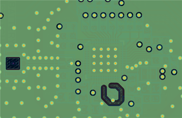

We are aware that there are some layout issues on our board, and while I tried adding additional capacitors to the internal DC/DC, it had no effect. I'm not sure how much the layout may impact this kind of instability.
Attaching logs, schematic, and layout files (with fixes marked).
Any advice or ideas on what else to check would be really appreciated!

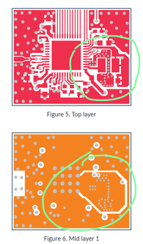

  • Can you share the GERBER files or Altium PcbDoc file?
    Is it only a two layer PCB?
    If you look at the ef design we have a bit of a uniqe layout and this is because of noise and interference. So that could be a part of the issue or the entire issue.
    Jonathan
  • Thank you for your response.
    Actually, the board is 6-layer, and I initially shared only the top two layers, as they differ the most from your reference layout. You are absolutely right, there are indeed some issues in the layout. In addition to what you've pointed out, I also noticed that some of the capacitors do not fully match the recommended placements from your design guidelines.
    Unfortunately, it’s difficult for us to assess how significantly these deviations affect the Wi-Fi stability.
    As requested, I'm attaching the Altium PcbDoc file of the board. Please note that I have made some minor modifications to the file, a few components, silkscreen elements, and signal traces were removed for confidentiality reasons. However, the layout around the nRF7002 is left fully intact and unchanged.
    I would greatly appreciate any feedback or suggestions regarding the layout and possible root causes of the instability.
    Understanding the cause of this issue is very important, as I want to make sure the problem does not repeat in the next board revision.
    Thank you again for your support!

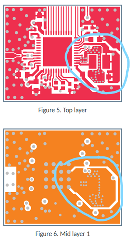

  • Sorry for the long wait here but I went over the Altium file here and main issue is still the area around the BUCK section.
    The 6 layers are ok, rest of the layers all look ok.
    What is missing is the extra vias and the isolated ground area under the BUCK section, this is a sensitive part so we strongly recommend that you copy the area here as best as possible.
    I dont see any issues i copying most of the layout here, it seems that there should be enough space here within the shield area as well to closely follow the ref design we have here.
    How many units was tested and showed the issue ?
    Are you able to run a radio test here with the nRF7002 and check how it preforms with e spectrum analyzer? either conducted or radiated?
    Jonathan
