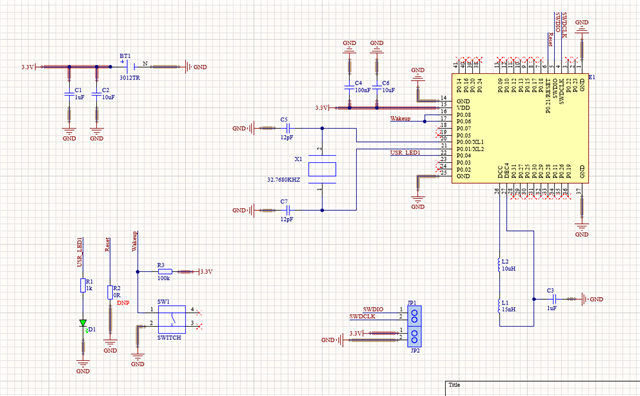

As you can see in the schematic, I have a custom board, and I’m uploading code to it via J-Link. I can control the pins, turn on an LED, and read a button without any problems. However, when I try to activate BLE, the program doesn’t work properly — the device doesn’t show up on my phone, and the other functionalities also stop working. By the way, I currently don’t have a 32.768 kHz crystal connected to the PCB. Can someone help me identify where the issue might be coming from?
  • The BTLE examples require the 32.768kHz crystal by default. You need to change the configuration in order to use the LFRC. Very often discussed here, should also be mentioned in the docs.
  • I'm trying to control it via Arduino. To make it use the internal oscillator, I added the following line to the boards.txt file:
    feather52832.build.extra_flags=-DARDUINO_FEATHER52 -DNRF_SDH_CLOCK_LF_SRC=1
    However, it didn't respond. Here's the code I used:

  • Hi
    -DNRF_SDH_CLOCK_LF_SRC=1-DNRF_SDH_CLOCK_LF_SRC=1 points to you using the external clock as a clock source. To use the internal RC oscillator, this option must be set to 0, and you need to set NRF_SDH_CLOCK_LF_RC_CTIV =16, NRF_SDH_CLOCK_LF_RC_TEMP_CTIV=2, NRF_SDH_CLOCK_LF_ACCURACY=1 to enable calibration as well.
