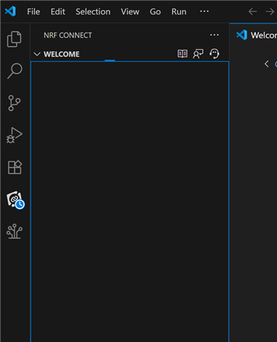

I'm having some pretty significant issues with Visual Studio Code and the nRF Connect SDK/Toolchain installation.
I'm on Windows 10, and have been running V2.6.1 of the SDK for a year or so now, but needed to update to a more recent one to access some features not available in V2.6.1.  Went through the usual process within Visual Studio Code when I can install a toolchain, and install an SDK.  The toolchain for v3.0.1 seems to download and install correctly.  But when I went to install the V3.0.1 SDK, it downloaded, unpacked and then the final step failed with some random error code:
[15:13:35] nrfutil-sdk-manager sdk,install,v3.0.1,--sdk-path,c:\ncs\v3.0.1: Download SDK v3.0.1
[15:36:38] nrfutil-sdk-manager sdk,install,v3.0.1,--sdk-path,c:\ncs\v3.0.1: null: success
[15:36:38] nrfutil-sdk-manager sdk,install,v3.0.1,--sdk-path,c:\ncs\v3.0.1: Calculating SDK checksum
[15:36:44] nrfutil-sdk-manager sdk,install,v3.0.1,--sdk-path,c:\ncs\v3.0.1: Verified download: success
[15:36:44] nrfutil-sdk-manager sdk,install,v3.0.1,--sdk-path,c:\ncs\v3.0.1: Unpack SDK v3.0.1
[west]: exited with code -4058.
And now, Visual Studio Code seems almost completely broken.  If I open up an existing Workspace, then attempt to click on the nRF Connect icon on the left, it just sits there looking like this:
I've left it sitting there like this for > 30mins and nothing seems to change.  Shutting down Visual Studio Code, restarting my machine, and restarting VSC doesn't seem to fix things.  I've even attempted a complete uninstall of nRF Command Line Tools and Visual Studio Code, then reinstalling, but it is still showing this behaviour.
I'm now at the point where I basically can't do any further development, nor program any boards I have going through production, so I'm pretty stuck.

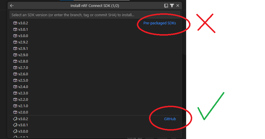

  • Hi Dejan,
    No, that didn't work.  I got this error:
    C:\WINDOWS\system32>nrfutil sdk-manager install v3.0.0 --sdk-path c:\ncs\v3.0.0 --install-dir c:\ncs
    [00:00:00] ###### 100% [Install toolchain v3.0.0] Compatible toolchain found in c:\ncs\toolchains\0b393f9e1b
    [00:39:33] ###### 100% [Download SDK v3.0.0] Download SDK v3.0.0
    [00:00:05] ###### 100% [Calculating SDK checksum] Verified download
    [00:00:14] ##----  28% [Unpack SDK v3.0.0] Unpacking
    Error: Subprocess C:\Users\mikea.SURFACE-PRO-7\.nrfutil\bin\nrfutil-sdk-manager.exe failed with unexpected exit code Some(5)
    The only approach that has been successful is to download the SDK via the GitHub option within VSC's "Install nRF Connect SDK" window.  If I try and use the pre-packaged SDK option, I get the error I described in my original post, and VSC seems to get hung up.
    I seem to be able to get things working again by taking this approach.
    Cheers,
    Mike
