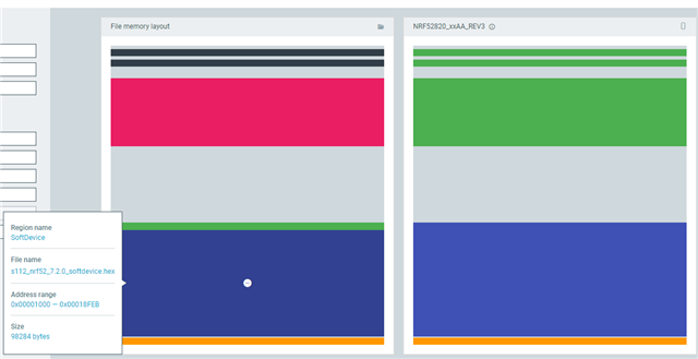

This is my hex distribution. The library used is nRF5_SDK_17.1.0_ddde560.

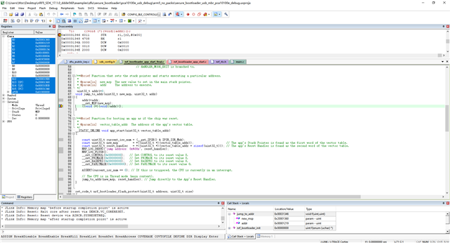

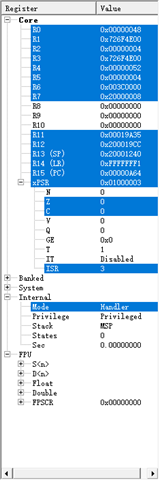

    Thanks. The readout shows that a fault exception has been raised. Are you building the bootloader with the default optimization setting? Reason for asking is that the jump_to_addr() function is known to fail if compiler optimization is not enabled.  It's because the implementation assumes that the input arguments will not be pushed on stack.
    If you need to troubleshoot this further, I suggest you start a debug session with your bootloader project and place a breakpoint in jump_to_addr() and try to single step from there to see if you can see when the fault is triggered.

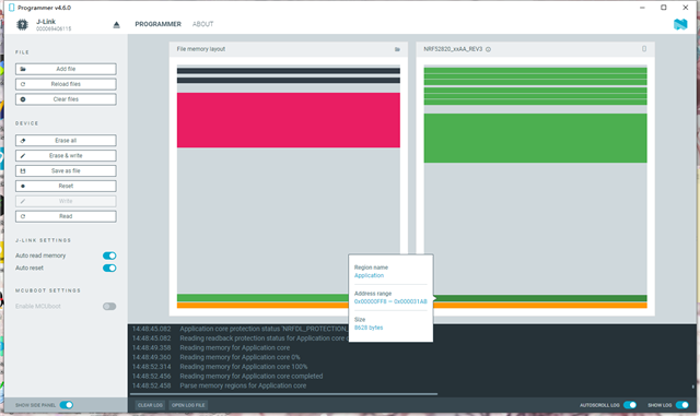

  • Look at this picture. There is an abnormal situation in this picture. That is, after I download the program on the left into the chip, the chip will generate three programs of approximately the same size occupying bytes in the "setting file" area. Is this normal?
  • Please debug the application then to see where the program hangs.
    The settings and MBR parameter page are updated by the bootloader at runtime, so yes, it is expected to change.
