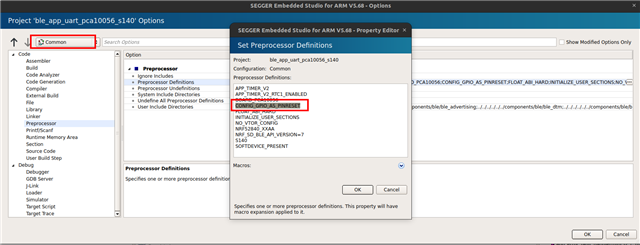

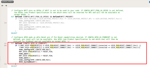

    The UICR registers are in FLASH which means you must erase the UICR section before you can update existing register values. It's also important that you don't have the CONFIG_GPIO_AS_PINRESET symbol set in your bootloader or application as this will cause the UICR.PSELRESET registers to be set again by the startup code here:
