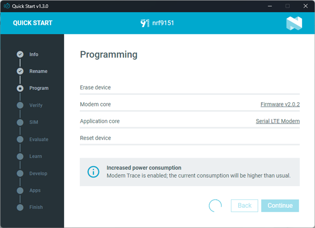

I was doing development on the development kit and I noticed that when flashing the device there is application core and modem core firmware that is flashed
I'm trying to figure out how to flash a production device with both the application and modem core firmware however the quick start doesn't allow a JTAG to be used to flash this. I imagine I can use the programmer, but I'm not sure what addresses to flash and what file to flash.

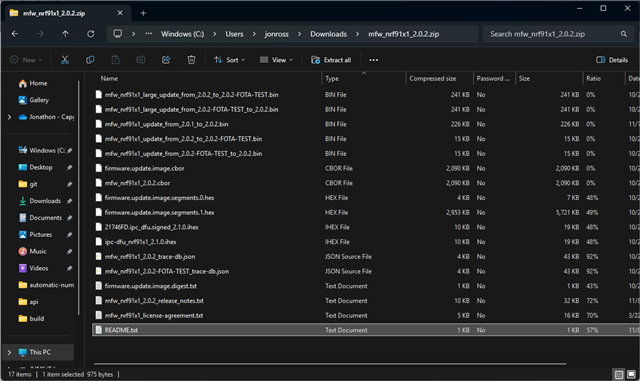

I've downloaded the modem core firmware from https://www.nordicsemi.com/Products/nRF9151/Download?lang=en#infotabs
It's also not very obvious which one of these should be used to flash.

    nRF91 Series devices come with preprogrammed modem firmware, that must be updated in production to the modem firmware version the end product is certified with. The modem firmware is not included in your application build and must be updated separately.

    You need to flash both the application firmware (your Zephyr-based app or a sample like Serial LTE Modem) and the modem firmware (modem core). These are separate binaries. You can either use the programmer app or nrfutil to do this. Using programmer, once you have selected the nRf91 device, Click "Add file" and select the modem firmware .zip file (do not unzip it). Then click "Write" to flash the modem. Then you can write the application firmware(Zephyr-built image (e.g., merged.hex or app_update.bin)).

  • Okay perfect, I usually used the "erase and write" where as the .zip only allowed the "write" method, it seems. Thanks so much for the info, this got me to where I needed to be!
