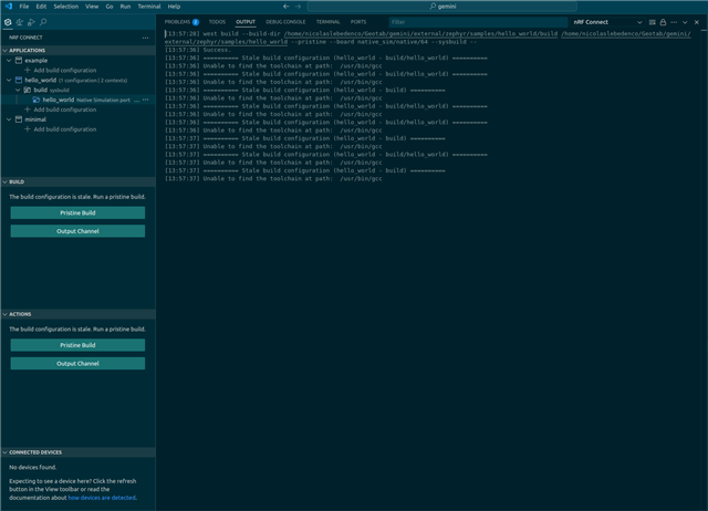

nRF Connect for VSCode does not recognize host toolchain when building for native_sim on Linux
Using VSCode with nRF Connect extension on Ubuntu Linux 22/04 with nRF SDK 3.0.1 and nRF Toolchain 3.0.1 installed
I can create a build configuration for Zephyr's hello_world sample app to build for the native_sim board and build without any issue but the IDE extension keeps asking for a pristine build afterwards despite no build errors being reported. In the VSCode output console (where extensions print log info) it  keeps on printing "Unable to find the toolchain at path: /usr/bin/gcc" like this.
[13:57:28] west build --build-dir /home/nicolaslebedenco/Geotab/gemini/external/zephyr/samples/hello_world/build /home/nicolaslebedenco/Geotab/gemini/external/zephyr/samples/hello_world --pristine --board native_sim/native/64 --sysbuild --
[13:57:36] Success.
[13:57:36] ========== Stale build configuration (hello_world - build/hello_world) ==========
[13:57:36] Unable to find the toolchain at path: /usr/bin/gcc
[13:57:36] ========== Stale build configuration (hello_world - build) ==========
[13:57:37] ========== Stale build configuration (hello_world - build) ==========
[13:57:37] Unable to find the toolchain at path: /usr/bin/gcc
[13:57:37] ========== Stale build configuration (hello_world - build/hello_world) ==========
The problem is that since the extension is not convinced that the project was built it hides all action buttons. All I get is this:
so it becomes impossible to debug/run without having to resort to custom launch commands or manually configuring gdb which defeats the purpose of using the extension in the first place.

    And this the output I get in VSCode when building zephyr/samples/hello_world for native sim using the nRF Connect Extension. As you can see the build does not fail.
    Executing task: nRF Connect: Generate config native_sim/native for external/zephyr/samples/hello_world
    Building hello_world
    west build --build-dir /home/nicolaslebedenco/Geotab/gemini-next/external/zephyr/samples/hello_world/build /home/nicolaslebedenco/Geotab/gemini-next/external/zephyr/samples/hello_world --pristine --board native_sim/native

    And then I can execute the resulting binary in the terminal just fine. The problem is that the nRF Connect Extension, despite recognizing the build because it appears listed in the `Applications` panel, does not accept it and instead of displaying the proper action buttons for me to run and debug in the `Actions` panel, the extension insists that the project must go through a pristine build forever again.
    And this is the resulting CMakeCache.txt of the hello_world app in case you are unsure about what you are seeing the output messages above.

  • I'm sure you can do better than this.
    First I'm building on Linux not Windows, second as I made clear from the start, the build does not fail. It is the extension that does not recognize `/usr/bin/gcc` as a toolchain, apparently...
    My system
    $ lsb_release -a
    No LSB modules are available.
    Distributor ID: Ubuntu
    Description: Ubuntu 22.04.5 LTS
    Release: 22.04
    Codename: jammy
    $ gcc --version
    gcc (Ubuntu 11.4.0-1ubuntu1~22.04) 11.4.0

    [38/96] Building C object zephyr/boards/native/native_sim/CMakeFiles/boards__native__native_sim.dir/misc.c.obj
    [39/96] Building C object zephyr/CMakeFiles/zephyr.dir/lib/heap/heap.c.obj
    [40/96] Building C object zephyr/boards/native/native_sim/CMakeFiles/boards__native__native_sim.dir/posix_arch_if.c.obj
    [41/96] Building C object zephyr/boards/native/native_sim/CMakeFiles/boards__native__native_sim.dir/cpu_wait.c.obj
    [42/96] Building C object zephyr/boards/native/native_sim/CMakeFiles/boards__native__native_sim.dir/nsi_if.c.obj
    [43/96] Building C object zephyr/soc/soc/native/CMakeFiles/soc__native__inf_clock.dir/soc.c.obj
    [44/96] Building C object zephyr/CMakeFiles/zephyr.dir/lib/os/cbprintf_packaged.c.obj
    [45/96] Building C object zephyr/kernel/CMakeFiles/kernel.dir/init_static.c.obj
    [46/96] Building C object zephyr/CMakeFiles/zephyr.dir/lib/utils/rb.c.obj
    [47/96] Building C object zephyr/arch/arch/posix/core/CMakeFiles/arch__posix__core.dir/thread.c.obj
    [48/96] Building C object zephyr/drivers/entropy/CMakeFiles/drivers__entropy.dir/fake_entropy_native_posix.c.obj
    [49/96] Building C object zephyr/drivers/timer/CMakeFiles/drivers__timer.dir/sys_clock_init.c.obj
    [50/96] Building C object zephyr/CMakeFiles/zephyr.dir/lib/os/cbprintf_complete.c.obj
    [51/96] Building C object zephyr/CMakeFiles/zephyr.dir/lib/utils/bitarray.c.obj
    [52/96] Building C object zephyr/kernel/CMakeFiles/kernel.dir/device.c.obj
    [53/96] Building C object zephyr/kernel/CMakeFiles/kernel.dir/banner.c.obj
    [54/96] Building C object zephyr/kernel/CMakeFiles/kernel.dir/version.c.obj
    [55/96] Building C object zephyr/subsys/random/CMakeFiles/subsys__random.dir/random_entropy_device.c.obj
    [56/96] Building C object zephyr/kernel/CMakeFiles/kernel.dir/main_weak.c.obj
    [57/96] Linking C static library zephyr/soc/soc/native/libsoc__native__inf_clock.a
    [58/96] Building C object zephyr/kernel/CMakeFiles/kernel.dir/errno.c.obj
    [59/96] Building C object zephyr/drivers/timer/CMakeFiles/drivers__timer.dir/native_posix_timer.c.obj
    [60/96] Building C object zephyr/drivers/console/CMakeFiles/drivers__console.dir/posix_arch_console.c.obj
    [61/96] Building C object zephyr/kernel/CMakeFiles/kernel.dir/fatal.c.obj
    [62/96] Building C object zephyr/kernel/CMakeFiles/kernel.dir/busy_wait.c.obj
    [63/96] Linking C static library zephyr/arch/arch/posix/core/libarch__posix__core.a
    [64/96] Linking C static library zephyr/drivers/entropy/libdrivers__entropy.a
    [65/96] Linking C static library zephyr/libzephyr.a
    [66/96] Linking C static library zephyr/subsys/random/libsubsys__random.a
    [67/96] Building C object zephyr/boards/native/native_sim/CMakeFiles/boards__native__native_sim.dir/irq_handler.c.obj
    [68/96] Linking C static library zephyr/drivers/console/libdrivers__console.a
    [69/96] Building C object zephyr/kernel/CMakeFiles/kernel.dir/float.c.obj
    [70/96] Linking C static library zephyr/drivers/timer/libdrivers__timer.a
    [71/96] Building C object zephyr/kernel/CMakeFiles/kernel.dir/kheap.c.obj
    [72/96] Building C object zephyr/kernel/CMakeFiles/kernel.dir/mem_slab.c.obj
    [73/96] Building C object zephyr/kernel/CMakeFiles/kernel.dir/sem.c.obj
    [74/96] Building C object zephyr/kernel/CMakeFiles/kernel.dir/system_work_q.c.obj
    [75/96] Building C object zephyr/kernel/CMakeFiles/kernel.dir/idle.c.obj
    [76/96] Building C object zephyr/kernel/CMakeFiles/kernel.dir/msg_q.c.obj
    [77/96] Building C object zephyr/kernel/CMakeFiles/kernel.dir/stack.c.obj
    [78/96] Linking C static library zephyr/boards/native/native_sim/libboards__native__native_sim.a
    [79/96] Building C object zephyr/kernel/CMakeFiles/kernel.dir/mailbox.c.obj
    [80/96] Building C object zephyr/kernel/CMakeFiles/kernel.dir/init.c.obj
    [81/96] Building C object zephyr/kernel/CMakeFiles/kernel.dir/mutex.c.obj
    [82/96] Building C object zephyr/kernel/CMakeFiles/kernel.dir/condvar.c.obj
    [83/96] Building C object zephyr/kernel/CMakeFiles/kernel.dir/queue.c.obj
    [84/96] Building C object zephyr/kernel/CMakeFiles/kernel.dir/priority_queues.c.obj
    [85/96] Building C object zephyr/kernel/CMakeFiles/kernel.dir/mempool.c.obj
    [86/96] Building C object zephyr/kernel/CMakeFiles/kernel.dir/dynamic_disabled.c.obj
    [87/96] Building C object zephyr/kernel/CMakeFiles/kernel.dir/timeslicing.c.obj
    [88/96] Building C object zephyr/kernel/CMakeFiles/kernel.dir/thread.c.obj
    [89/96] Building C object zephyr/kernel/CMakeFiles/kernel.dir/timeout.c.obj
    [90/96] Building C object zephyr/kernel/CMakeFiles/kernel.dir/timer.c.obj
    [91/96] Building C object zephyr/kernel/CMakeFiles/kernel.dir/work.c.obj
    [92/96] Building C object zephyr/kernel/CMakeFiles/kernel.dir/sched.c.obj
    [93/96] Linking C static library zephyr/kernel/libkernel.a
    [94/96] Linking C executable zephyr/zephyr.elf
    Generating files from /home/nicolaslebedenco/Geotab/gemini-next/external/zephyr/samples/hello_world/build/hello_world/zephyr/zephyr.elf for board: native_sim
    [95/96] Building native simulator runner, and linking final executable
    [96/96] Running utility command for native_runner_executable
    [7/8] No install step for 'hello_world'
    [8/8] Completed 'hello_world'
    * Terminal will be reused by tasks, press any key to close it.
