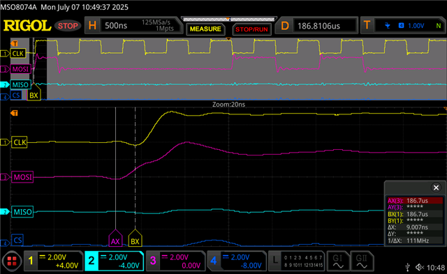

- On the oscilloscope, the MOSI line only transitions to ‘1’ on the rising edge of SCK instead of being centered between clock edges
- As a result, the slave samples the wrong value for the first bit if it is ‘1’.
- This behavior only affects the first 8-bit word after each CSN (SS) activation, and only if the first bit is '1'.

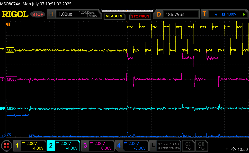

Oscilloscope captures:
The first bit transitions to ‘1’ on the rising edge of SCK instead of being centered between clock edges
Can you confirm if anything else is required on the application (or configuration) side to ensure the workaround is fully effective when using Zephyr’s SPI API? Are there any known limitations or further steps to handle this errata in this context?

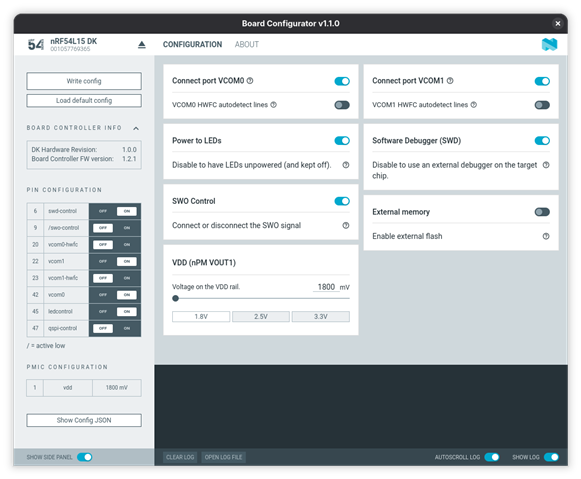

    This DK includes an SPI flash module configured in the device tree, so we can use it to reproduce the behavior.
    To get the SPI signal on the header, you must use the board configurator and disable the external memory, as shown here:
    Below is a minimal example that sends data over SPI using the default SPI00 pinout that is:

    And screen from osciloscope. SCK on top, MOSI on botton:
