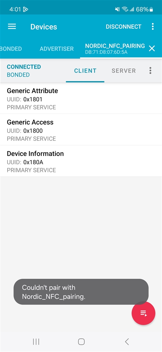

The peripheral_nfc_pairing sample code pairs and connects, but Android shows a "Couldn't pair" message
I have been trying to use the `nrf\samples\bluetooth\peripheral_nfc_pairing` sample code on the nRF Connect SDK v3.0.2 to connect to a Samsung Galaxy A16 5G phone.
The NFC pairing seems to work, and the connection is working. However, every time the pairing is done, after 20 seconds, I get a message pop-up toast from the Android OS saying "Couldn't pair with Nordic_NFC_pairing". See the screenshot below that shows the pop-up and the bonded connected state of the nRF Connect app. I have also tried clearing the bonded devices on both the nrf5340dk and the phone, but it looks the same.
I have seen people reporting a similar issue before:
Given that the items above are all very old. I was wondering if there are any updates on this.
How do you suggest that I hide the pop-up toast message?

  • It never terminates. The connection is stable. I mentioned earlier that if the error doesn't appear, we would never sense that something is wrong.
    It seems like even though the whole bonding and connection is complete, the Android phone still has more procedures that are not handled.
    We may be able to go faster if you would try the sample code (on nrf5340) yourself on any Android phone and tell me if you can reproduce it, and you would be able to try different configurations.
    Here is my explanation.
    On Android (and iOS) each app can connect to a Bluetooth device independently, even using multiple clients (BluetoothGatt objects). The system is maintaining the physical connection and provides a 'virtual' connection to each client. Disconnecting from one client does not mean terminating the connection, just closing that virtual connection. Received notification is forwarded to all clients that "listen" to the given characteristic, but each client can send and read values independently.
    When you tap a device with NFC pairing sample the Android system starts pairing. Natively, it can support number of services, like HID, FIDO and perhaps some more. To pair it needs to connect. Connection event is broadcasted to all apps, including nRF Connect, which intercepts it and creates another virtual connection of its own. It also listens to bond state changes, so the app shows "BONDING..." and "BONDED". As you say, this app (and any other that would have similar behavior) behaves as expected.
    However, the system, when pairing is complete, performs service discovery, checks that your device does not have any supported services (NFC pairing sample has only Device Information service), so it disconnects. Instead of doing it silently, it shows a toast: "Could not connect. Nordic_FC_pairing". This is incorrect and it should not have done that.
    Regarding "Coundn't pair with ...", it is either the same error, just with different wording, or the pairing fails on some phones. I wasn't able to reproduce that error yet.

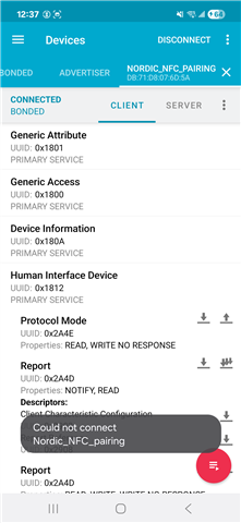

    Regarding the first part - it will always start a service discovery, as the system is looking for service which it may support, like HID.
    Regartding the second part - this is a very interesting question. First of all, I would search for the code that displays the error message. I found where "Couldn't pair with ..." is sent: https://cs.android.com/android/platform/superproject/main/+/main:frameworks/base/packages/SettingsLib/src/com/android/settingslib/bluetooth/BluetoothEventManager.java;l=459 (and there's a listener added to BluetoothUtils that shows a Toast if the Settings app is in background).
    This one, however, is more interesting, as it shows which service is the Android looking for:
    https://cs.android.com/android/platform/superproject/main/+/main:packages/modules/Nfc/NfcNci/src/com/android/nfc/handover/BluetoothPeripheralHandover.java;l=466?q=connect_peripheral_failed
    Seems like only for HID service, and if found, it will show a toast saying Connected (which may be better, than Cannot Connect). Try adding an empty (?) HID Service.
  • I tried adding pieces of the HIDs Keyboard sample into the NFC pairing in a way that I can see the service and its characteristics inside nrf Connect app. But sadly, the error still shows up.
    Here is my patch:
