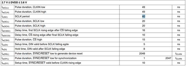

SPI speed and consistency issues using nRF52840 with ADS131M04EVM
Howdy!

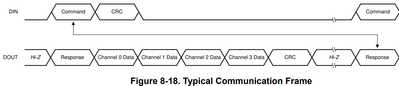

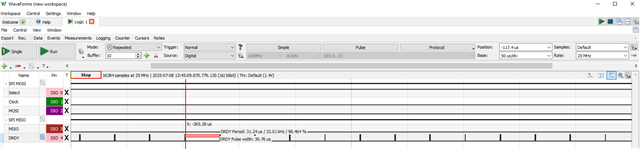

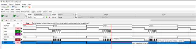

I am attempting to develop a system using an nRF52840 and an ADS131M04EVM (ADC). Our application requires us to collect data at a high sampling rate (>= 16k SPS). According to the ADS131M04 datasheet, this should be well within its possible data rate. The max data rate using high resolution mode should be 64k SPS. However, using our current hardware set up and software, we are maxing out at ~11k SPS (even before trying to process and send the data off the device). It seems like part of the limiting factor for our speed is lag from the Chip Select pin. The ADS131 pulls the DRDY pin high whenever new data is available for reading. When we are just letting the ADS131 run, the DRDY pin will run at the correct frequency.
However, when we try to read data from the ADS131 using spi_tranceive_dt() according to the method described in the data sheet, the communication / Chip Select speed seems to limit our ability to read in values at a higher rate. The Chip Select seems to stay low well after we are done communicating.
We have tried increasing the SPI max frequency and that helped marginally. We are using SPI3, so that we can run the system at 32MHz. However, when we try to increase the SPI max frequency above ~15MHz we begin to get inconsistent reads from the ADS131 even though the ADC should be able to handle up to 25MHz. For instance, the Device ID would send a value of 0x28 about half the time instead of the correct value of 0x24.
Any guidance on improving the speed and inconsistency of our SPI reading / writing would be greatly appreciated! I am not sure what else to optimize because it seems like the provided SPI transceive function is part of the problem.

#define SPIOP_ADS131 (SPI_WORD_SET(8) | SPI_TRANSFER_MSB | SPI_MODE_CPHA)
struct spi_dt_spec spi_dev = SPI_DT_SPEC_GET(DT_NODELABEL(ads131m02), SPIOP_ADS131, 0);

    while (sample_index < NUM_SAMPLES) {
        if (interrupt_flag && !busy) {
            busy = true;
            interrupt_flag = false;
            uint8_t tx_buf[15] = {0};
            uint8_t rx_buf[15] = {0};
            if (SPI_IO_Transfer(&spi_dev, tx_buf, rx_buf, sizeof(tx_buf)) != 0) {

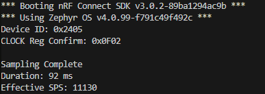

    end_time = k_uptime_get();
    uint32_t duration = end_time - start_time;
    float sps = (1000.0f * NUM_SAMPLES) / duration;
    printk("\nSampling Complete\n");
    printk("Duration: %u ms\n", duration);
    printk("Effective SPS: %d\n", (int)sps);
    while (1) k_sleep(K_FOREVER);

  • Hi Benjamin,
    I will try to suggest some changes relevant to PCA10056 (nRF52840 DK). On PCA10056, the ADS131M04EVM’s CS actually sits on P0.28 and the data-ready pin on P0.11 (not P0.15/17). Also change a bit of the code to switch to zero-delay CS toggling and reuse static SPI buffers so we shave a few microseconds each transfer. You dts should have something similar to below
    &spi3 {
        status = "okay";
        #address-cells = <1>;
        #size-cells    = <0>;
        /* ADS131M04 on SPI3 CS line 0 */
        ads131m02: spidev@0 {
            compatible           = "ti,ads131m04";
            reg                  = <0>;                     /* CS = SPI3-CS0 */
            spi-max-frequency    = <20000000>;              /* 20 MHz SCLK, reliable under 25 MHz limit */
            cs-gpios             = <&gpio0 28 GPIO_ACTIVE_LOW>;  /* P0.28 wired to ADS131nCS */
            drdy-gpios           = <&gpio0 11 GPIO_ACTIVE_HIGH>; /* P0.11 wired to ADS131nDRDY */
            status               = "okay";

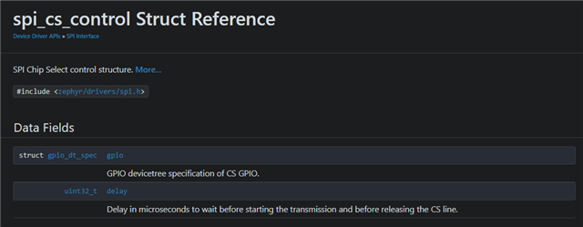

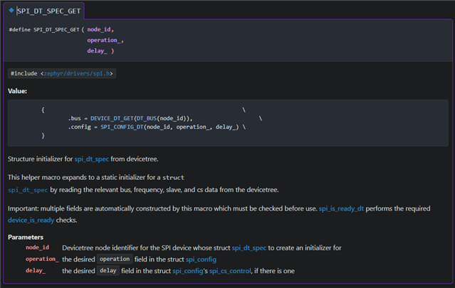

  • Thanks for the suggestions!
    I believe the static buffer suggestion will help with some of the performance, but I have been having some trouble implementing some of your recommended changes and was hoping you could provide some clarification.
    1) As long as I redefine the pins in my overlay file (CS, MISO, MOSI, DRDY, etc.), should I not be able to use any GPIO pins without affecting performance? The PCB we eventually hope to run our code on does not use the standard configuration of the DK for SPI.
    2) For changing the delay of the chip select pin, is this not done by the third argument of SPI_DT_SPEC_GET automatically?
    3) I tried to set up my code to follow your example as best as I can tell, but there seems to be some discrepancies between your example and the Zephyr documentation. In addition, according to the .yaml file for the ADS131 provided by TI, they want the chip select pin to be in the parent node of the ads131m02 (At one point, I did make a custom .yaml for storing the cs as you did, but that did not seem to be the root problem). The project builds, flashes, and begins running successfully on the board, but it seems to break whenever I try to call spi_transeive() for the first time. I have attached my overlay file and my new main.c file where I have been testing things. Any further guidance you could provide would be greatly appreciated.
