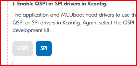

  • I followed Exercise 3, which, for NCS version 2.6.0, refers back to Exercise 2. In Exercise 2, the note section mentions a sample for using external flash via SPI on the nRF7002 DK. I checked that sample, but it is meant for USB and not BLE DFU.
    I also referred to Exercise 5, which covers BLE DFU. However, the sample provided there uses external flash via QSPI. On the nRF7002 DK, QSPI is already used by the Wi-Fi module, so I can't use it for external flash.
    What I need is a BLE DFU sample for the nRF7002 DK that uses SPI for external flash.
    There is no official ready-to-use sample, but the configuration steps are documented (using SPI on nRf7002-DK in exercise 2 and BLE DFU in exercise 5). You must manually adapt the BLE DFU sample to use SPI external flash on the nRF7002 DK. See here:  RE: nrf5340 DFU with external flash
    Basically, adapt the steps mentioned and choose SPI in exercise 3:
    I would also suggest that you refer this discussion:  RE: FOTA over BLE using external flash (nRF Connect SDK 2.9.0) - upload to device stuck . Note that it is for nRF52840 DK and will require pin and overlay adjustments for the nRF7002 DK.

    You need to make this CONFIG_SPI_NOR=y. Also try adding  CONFIG_PM_EXTERNAL_FLASH_MCUBOOT_SECONDARY=y
    A frequent cause for the swap not occurring is a mismatch between the primary and secondary image slot sizes. Both must be the same size for MCUboot to perform the swap correctly. If the secondary slot (in external flash) is smaller or not properly aligned, the swap will fail silently or get stuck. See here:  Unable to do FOTA using Bluetooth and external flash memory .
    Also, for the network core, make sure you have the b0n bootloader enabled. See discussion here:  nRF5340 custom board using sysbuild missing "SUPPORT_NETCORE" causing issue to enable b0n build
