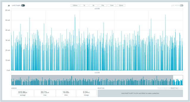

I am experiencing issues with the current measurements taken by the PPK2 when using the nPM2100-EK to power a device. The current drawn from the 2.7V power source (PPK2) is lower when using the nPM2100 (configured to output 3.0V) compared to a direct connection without the nPM. This is clearly incorrect. How should the PPK2 be configured to reliably measure our system, including the nPM2100?
The system is a Bluetooth-enabled measurement device that uses an nRF52840 chip. When connected to a Bluetooth master, the system draws an average current of around 530µA at 2.7V, which is quite high for a CRxxxx coin cell primary battery. Therefore, I would like to use the nPM2100 to boost the voltage to a constant value of 3.0V. However, when using the nPM2100-EK for this purpose, the PPK2's current measurement shows large spikes and an average value of only 320µA. As the nPM2100 does not generate energy, this measurement must be incorrect.
I am using Power Profiler Version 4.2.2 and even a second PPK2 produces similarly incorrect results. I have read about the phantom spikes occurring at the highest sampling rate. I therefore selected a sampling rate of 10kHz, but the values are still incorrect.
Has anyone else experienced this issue? What is wrong with the PPK2 measurements?

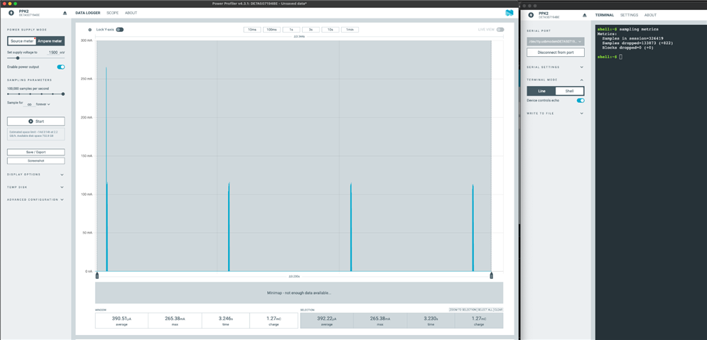

    Secondly, the FW on the PPK2 can discard measurements. When the PPK2 firmware suspects there is a measurement error caused by a measurement range transition happening at an inopportune time, the measurement is discarded.

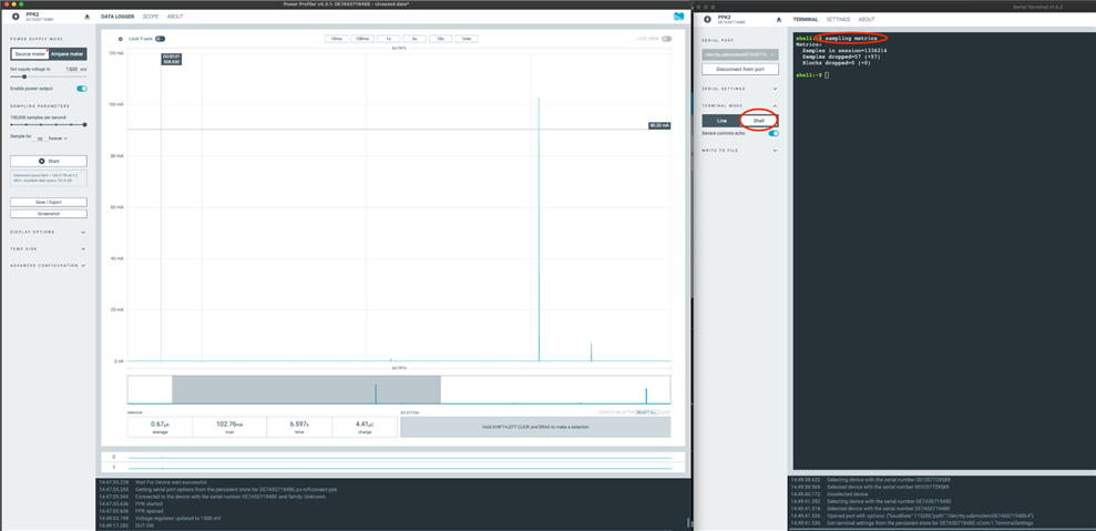

    You can retrieve metrics from the PPK2 as described below. If there is a high amount of “samples dropped”, this would indicate that the PPK2 struggles with this particular load.
    The more recent version of PPK2  firmware has a 2nd tty/COM port that can be used for shell access. Open this port using for example the nRF Connect Serial Terminal application, and execute the “$ sampling metrics” shell command after you have stopped sampling.
    (The shell is by design unresponsive while sampling is active)
    This screenshot is taken without any load on nPM2100 EK VOUT.  VBAT = 1.5 V, VOUT = 3 V
    Adding a 20 mA load pulse lasting 10 ms at 1 Hz generates more dropped samples:

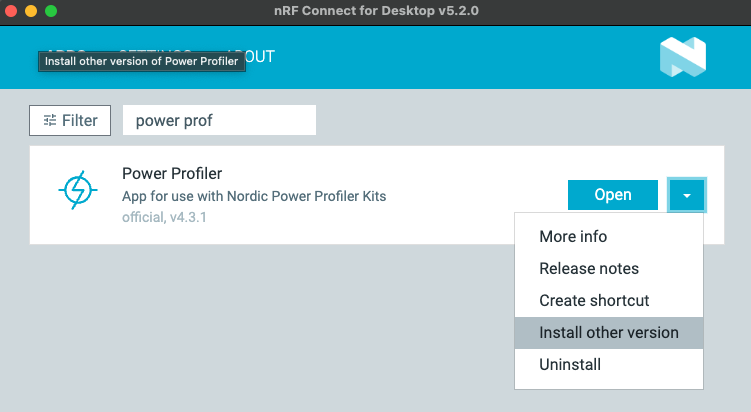

    Thirdly, it’s also possible to compare with an older PPK2 firmware version by downgrading the Power Profiler app to v4.1.3:

    Downgrading the PowerProfiler software to v4.1.3 also downgrades the PPK2 firmware to an earlier version, predating the introduction of shell access. Therefore, I was unable to check the dropped samples. However, this version does not improve the measurement accuracy.
