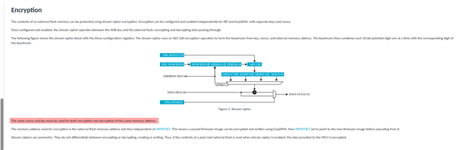

    Since this is currently not supported in the driver I'm not sure how this HW feature is supposed to be used, but it seems to me that the issue is that the wrong nounce is used when encrypting and decrypting the image trailer data.
    Could it be an option to disable the stream cipher when reading or writing image trailer data?
    Vidar
  • ut it seems to me that the issue is that the wrong nounce is used when encrypting and decrypting the image trailer data.
    This nounce is loaded only once during the boot process. It is not called from any other location.
    I added the printing function inside, but it only appeared once. There shouldn't be any other modifications elsewhere.
    Could it be an option to disable the stream cipher when reading or writing header data?
    Do you mean that when operating this, I need to temporarily disable both the encryption registers?
    The same nonce and key must be used for both encryption and decryption of the same memory address.
    Regarding this, I encrypted an entire external flash. So, should stream ciphers related to the external flash automatically perform encryption and decryption?
    Because all other external flash operations are normal encryption and decryption processes, and there are no issues with data writing and reading.

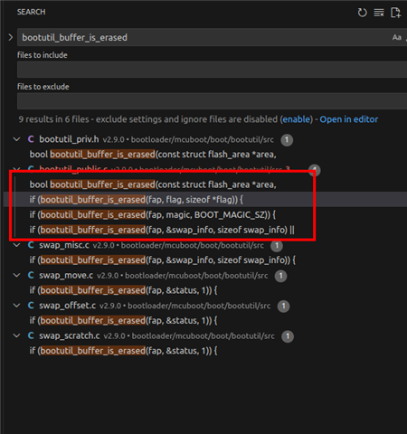

    First of all, since I enabled QSPI encryption, after erasing the secondary partition before downloading the firmware, I need to write 0xFF to the last block of the flash.
    After writing, the 4k data was read out and printed - all of them were 0xFF (normal)
    Then, the next step is the firmware download process.
    Then it comes to the boot_set_next function. The magic and swap_info values read out through the boot_read_swap_state function are all 0xFF.
    It will set
    state->magic = BOOT_MAGIC_UNSET;
    state->swap_type = BOOT_SWAP_TYPE_NONE;
    state->image_num = 0;
    And the next step is boot_write_magic
    As soon as I entered, I read 4kb of data, then came the "flash_area_write magic" process, and finally I read it back out.The data written at this time is inconsistent with the data read out.

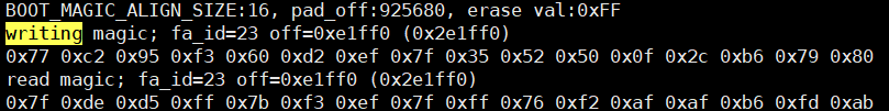

        printk("boot_write_magic before------------------\n");
        rc = flash_area_read(fap, 0xE1000, rewrite_buf, 4096);
        for(uint32_t i=0; i<4096; i++) {
        	printk("0x%02x ", rewrite_buf[i]);
        	if ((i + 1) % 16 == 0) {
        		printk("\n");
        off = boot_magic_off(fap);
        /* image_trailer structure was modified with additional padding such that
         * the pad+magic ends up in a flash minimum write region. The address
         * returned by boot_magic_off() is the start of magic which is not the
         * start of the flash write boundary and thus writes to the magic will fail.
         * To account for this change, write to magic is first padded with 0xFF
         * before writing to the trailer.
        pad_off = ALIGN_DOWN(off, BOOT_MAX_ALIGN);
        erased_val = flash_area_erased_val(fap);
        printf("BOOT_MAGIC_ALIGN_SIZE:%u, pad_off:%u, erase val:0x%02X\n", BOOT_MAGIC_ALIGN_SIZE, pad_off, erased_val);
        memset(&magic[0], erased_val, sizeof(magic));
        memcpy(&magic[BOOT_MAGIC_ALIGN_SIZE - BOOT_MAGIC_SZ], BOOT_IMG_MAGIC, BOOT_MAGIC_SZ);
        printf("writing magic; fa_id=%d off=0x%lx (0x%lx)\n",
                     flash_area_get_id(fap), (unsigned long)off,
                     (unsigned long)(flash_area_get_off(fap) + off));
        rc = flash_area_write(fap, pad_off, &magic[0], BOOT_MAGIC_ALIGN_SIZE);
        for(uint8_t i = 0; i < BOOT_MAGIC_ALIGN_SIZE; i++) {
           printf("0x%02x ", magic[i]);
        printf("\n");
        k_busy_wait(1000);
        rc = flash_area_read(fap, pad_off, &read_magic[0], BOOT_MAGIC_ALIGN_SIZE);
        if (rc != 0) {
            printf("error flashhhhhhhhhh 333333\n");
            return BOOT_EFLASH;
        printf("read magic; fa_id=%d off=0x%lx (0x%lx)\n",
           printf("0x%02x ", read_magic[i]);
        printf("\n");
        printk("afterrrrrr------------------\n");
        		printk("\n");
        return 0;
    logs
    0xff.....
    .....0xff
    BOOT_MAGIC_ALIGN_SIZE:16, pad_off:925680, erase val:0xFF
    writing magic; fa_id=23 off=0xe1ff0 (0x2e1ff0)
    0x77 0xc2 0x95 0xf3 0x60 0xd2 0xef 0x7f 0x35 0x52 0x50 0x0f 0x2c 0xb6 0x79 0x80
    read magic; fa_id=23 off=0xe1ff0 (0x2e1ff0)
    0x77 0xc3 0xb5 0xf3 0xfa 0xf2 0xef 0x7f 0xf5 0xf6 0xf9 0x8f 0x3c 0xfe 0xff 0xc0
    0xff....
    Then I attempted to write the data here after erased the flash partition again.
    After erasing, the values read out all appear to be encrypted? Because the erasure operation simply sets it to 0xFF, and then I enabled QSPI encryption, the read-out value is the random value obtained by decrypting the plaintext 0xFF.
    At this point, write "magic" again, and then read it again. The data will be consistent.

    Therefore, I am quite puzzled. Is there an issue with the operation of rewriting to 0xFF in the previous step img_mgmt_erase_image_data? However, without this step, there will be problems with the judgment in boot_read_swap_state because the values read are random rather than 0xFF.
    Why, after erasing again, did the reading and writing magic become problem-free once more?
    Perhaps I have some misunderstandings regarding the QSPI encryption and the firmware verification during the Bluetooth upgrade process.
  • yes, so I rewrote the 0xFF to the flash area . but here has a new problem below
  • A write operation can only flip 1's to 0's. An erase is needed to flip all 0's bits back to ones. For this reason, you must first perform an erase before updating an existing value in flash.
    When the encrypted value of the 0xFFs is written to flash, the section is no longer erased, and the image trailer (including the magic word) cannot be written at that location unless another erase is performed.
  • When the encrypted value of the 0xFFs is written to flash, the section is no longer erased, and the image trailer (including the magic word) cannot be written at that location unless another erase is performed.
    Yes, currently if I not write the 0xFF in  img_mgmt_erase_image_data , that the boot_set_next will return BOOT_EBADIMAGE because the value is radom and decode magic value is not boot_img_magic.val
    But if I write the 0xFF in img_mgmt_erase_image_data , that the write_boot_magic will failed such as before, writing and reading value is inconsistent. It needs erase again that the value will be consistent
