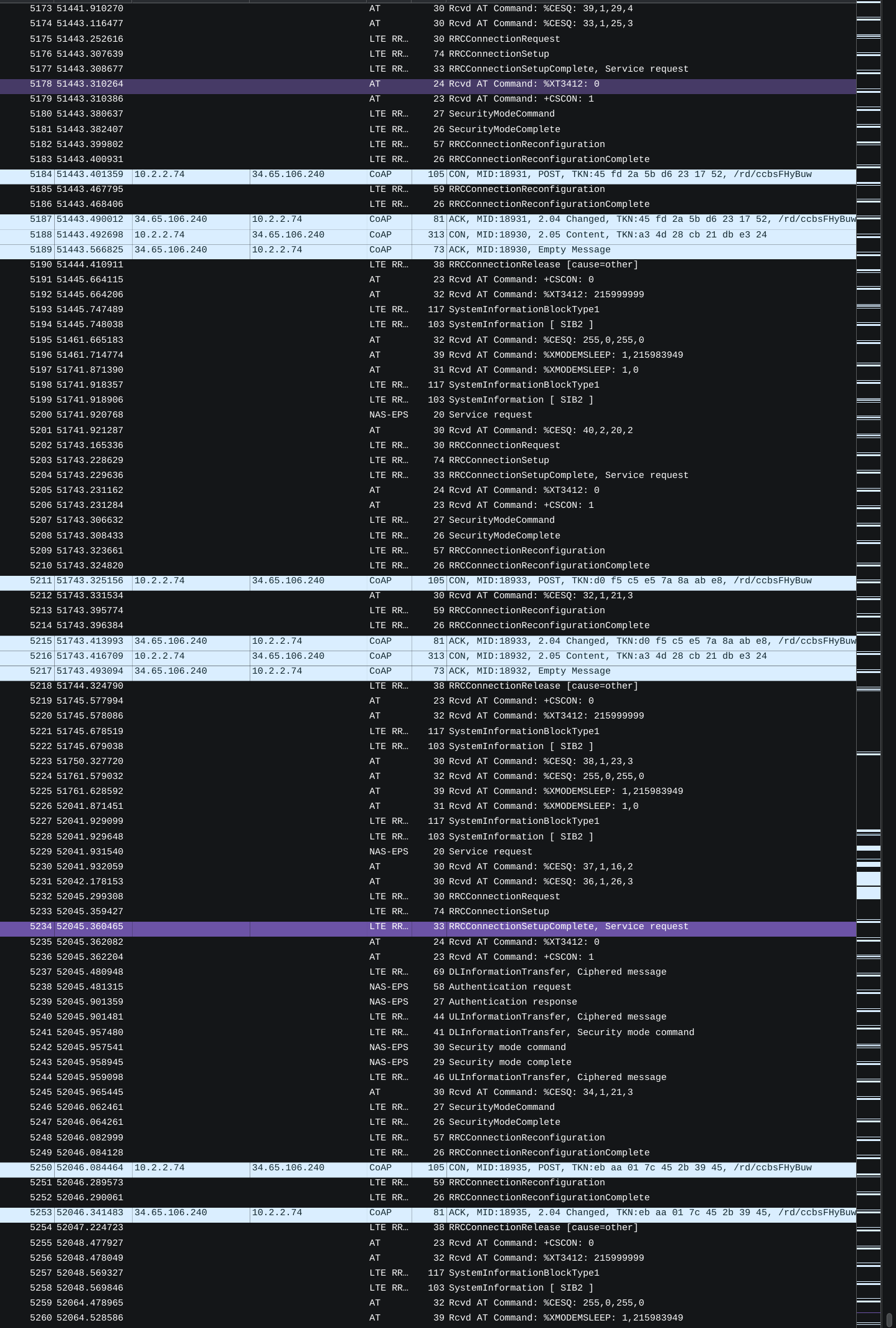

Sorry I can't provide a decrypted modem trace, but I hope the screenshots are enough to show what's happening.
We have been encountering a strange issue lately.

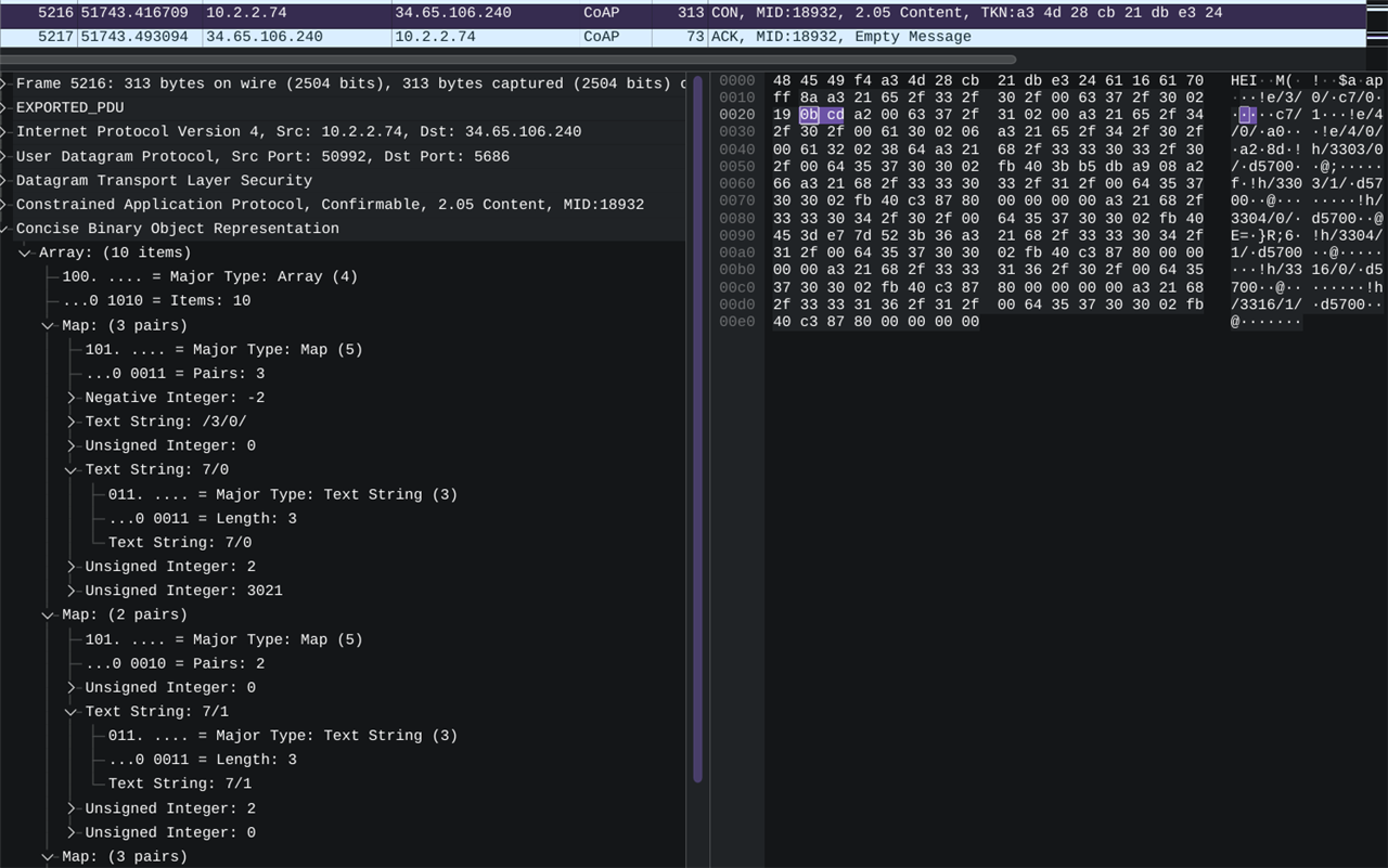

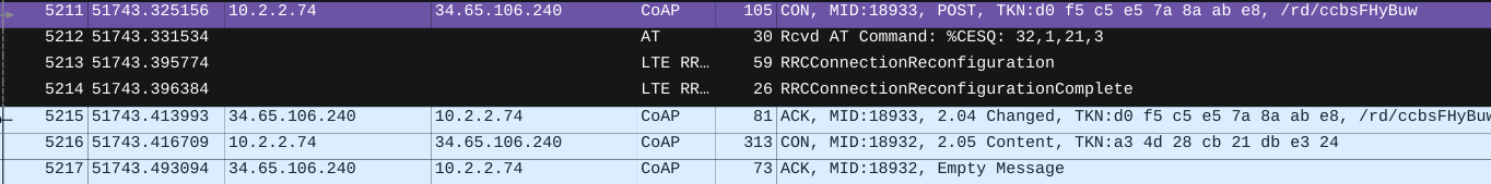

With the composite observer set, normal behaviour is as follows:
1. (5211) When it's time to trigger the observer update (e.g. when pmax is reached), the device sends the registration update CON message,
2. (5215) receives an ACK from the server
3. (5216) Device sends all observed values in cbor format in a further confirmable message:
4. (5217) The Server acknowledges this message.
The issue now is that somehow sometimes and suddenly Steps 3 and 4 just completely stop occuring without any clear reason / indication / error code:
I have the device logs for the same issue, where the observer updates just stop without any error or anything obvious (ignore the sensor reading errors, the sensors are not connected):
