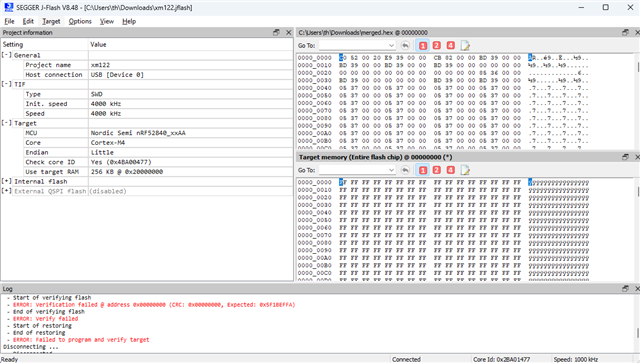

I am not able to program an Acconeer xm122, which is powered by an 52840. It is mounted on the Acconeer xb122 shield. My nrf52832DK is connected to the shield using a 10 pin SWD/JTAG cable.
Before I start programming my xm122 software of Acconeer was installed. This software generates log messages I saw using RTT Viewer.
I used Segger J-Flash V8.48 for programming the device. Please see the logfile of programming the xm122 in the following lines.

 - ERROR: Verification failed @ address 0x00000000 (CRC: 0x00000000, Expected: 0x5F1BEFFA)
 - End of verifying flash
 - ERROR: Verify failed
 - Start of restoring
 - End of restoring
 - ERROR: Failed to program and verify target
After readback the content of flash memory I see it is blank. Please see attached Screenshot.
I appretiate for any suggestions to solve my issue.
