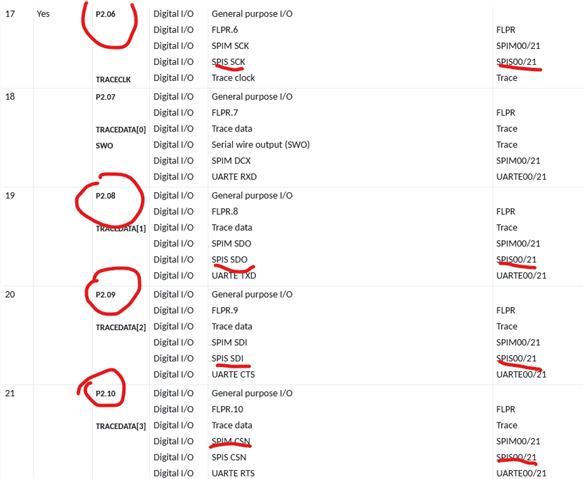

Hi
We don't get notifications on "Verified" answer tickets, so I didn't see this until you tagged me. Sorry about that. If you're working on a DK, some of these pins are used for other things by default, so that's the most likely reason this doesn't work by default. On the back of the nRF54L15 DK you can see that P2.09 for example is used for one of the onboard LEDs, so you need to make sure it isn't configured for the LED in your project.

Hi https://devzone.nordicsemi.com/members/simonr
Still trying to figure why your suggested pinout
Re:
CS - P2.10
CLK - P2.06
SDO - P2.08
SDI - P2.09
does NOT work for my setup as documented under my ticket with Kazi 359159
Looking into the "pin assignment" page, those choices are valid as highlighted in the attachment below
Your detailed feedback would be very much appreciated, either here or under the other ticket 359159.
Thank you and kind regards,
Jamal
