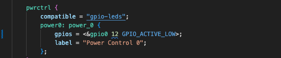

I copied the routine nRF Desktop in nRF Connect SDK V3.0.2 for test and added the following code to switch internal power supply to LDO in app.overlay.
At the same time I added the following code for test in the same file.
My module looks like keeps resetting after I burn the firmware, according to the waveform of P0.12.
May I ask how I can make the routine run normally on my module?

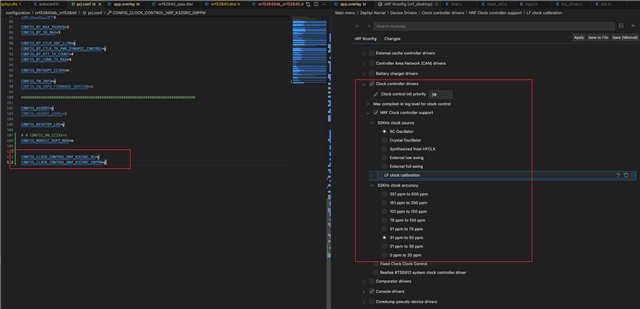

    I find the difference is my main board doesn't have 32.768kHz RC oscillator(LFRC).
    So I reconfigured my project with adding following setting
    Of course, it doesn't have QSPI Nor Flash, so I disabled QSPI Nor Flash too。
    Until now, it can run in Debug mode, but still blocked in full speed running mode.
    It seems to be related to correct configuration of LFRC. Is my configuration the correct one?
    By the way, no matter how I add configuration to the project it still can run on nRF52840DK board.
  • I guess maybe the issue is you enabling:
    CONFIG_CLOCK_CONTROL_NRF_K32SRC_50PPM=y
    These configs assume that you have an LFRC or crystal. So maybe you could try to use:
    CONFIG_CLOCK_CONTROL_NRF_K32SRC_SYNTH=y
    CONFIG_CLOCK_CONTROL_NRF_K32SRC_RC=n
    CONFIG_CLOCK_CONTROL_NRF_K32SRC_XTAL=n
    This is LFCLK which is synthesized from the HFCLK. Also, disable caliberation as it migh require an actual LFCLK:
    CONFIG_CLOCK_CONTROL_NRF_CALIBRATION=n

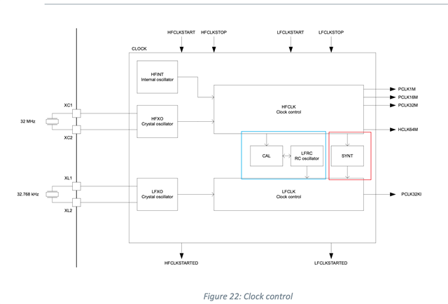

  • I found such a graph from the data sheet. The red box should be the configuration you suggested, and the blue box is my previous configuration. I had test both two configurations. They have the same result.

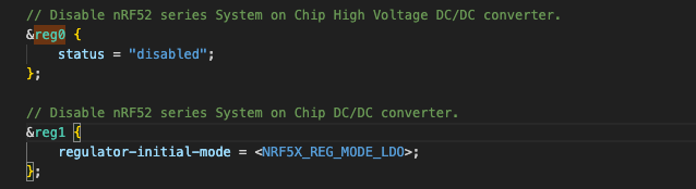

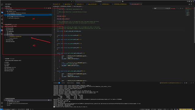

  • OK! I finally found the point in this issues.
    #1 has three items in the project and nrf_desktop include app.overlay, s1_image also include it. But b0 dosn’t include app.overlay. You can see it in follow picture. (#2 hasn’t include app.overlay)
    So this project will block in b0 because b0 is set to DCDC. My board is used LDO.
    I wrote the regulator configure code as follow in the file nrf52840dk_nrf52840.dts which is included by three items in #1.
    Now my board can run without connect to the debugger.
