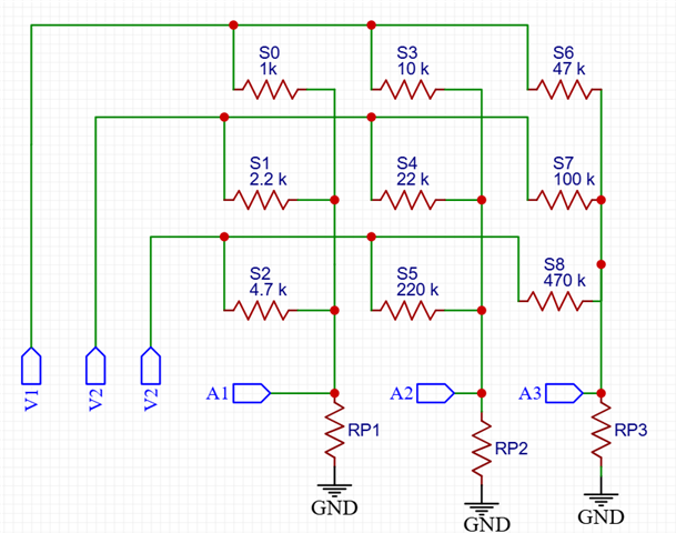

I am working on a new hardware design of analog sensors, which I want to sample their reading using SAADC.
I use nrf52832 PCA10040 DK, and softdevice s132 for sending data over BLE.
The thing is that I have been trying for a while to read properly the sensors which are connected to each other in a grid form as i will describe below. In order to evaluate my code first, I created the same grid with resistors, so I know the expected values.
the grid is:
Which is  9 resistors, with 3 signal lines and 3 power lines.
S0, S1, S2 are connected to the same analog pin A1,
S3, S4, S5 are connected to the same analog pin A2,
S6, S7, S8 are connected to the same analog pin A3. (every column of the grid is connected to the same analog input pin)
while
S0, S3, S6 are connected to the same power line, and respectively every row of the grid is connected to the same power line.
The idea is that if we disconnect every pin and set only V1 high and connect only A1 analog pin to the ADC, we will read the "signal" of the resistor S0 only without any interference of the rest.
However, I have not got yet the expected results and I would like some help if there is something wrong in the pin handling or generally in the code or maybe there is something wrong with the circuit that I have not thought and the reading of a specific resistor without cross-talk is impossible.

Expected values (since there is an internal resistor 13k and using the formula of pull-down resistor):
[S0,  S3, S6]       [15232,  9259,  3550]
[S1,  S4, S7]   =  [14015,  6086,  1884]
[S2,  S5, S8]       [12034,  914,     441]
And what i get is this :
So the first column is quite close, but the rest isn't. Is it something impossible due to hardware design what i am trying to achieve or am I doing something wrong?

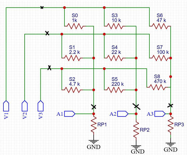

  • "The idea is that if we disconnect every pin and set only V1 high and connect only A1 analog pin to the ADC, we will read the "signal" of the resistor S0 only without any interference of the rest."
    Not so for other than S0, S1 and S2; assuming the dots on the schematic are connections and not open switches.
    Note also there are two pulldown resistors; the internal bias pulldown for the SAADC is 160k and the internal pulldown for an input pin is about 13k. That second input pin pulldown is not documented to work on the pin in SAADC mode, though I believe it does work.
      channel0_config.resistor_p = NRF_SAADC_RESISTOR_PULLDOWN; //Disable the 13k pulldown resistor. (Bypass resistor ladder).

    Hello again,
    I created this circuit on my breadboard and I still cannot read the resistors properly. Can you find maybe the issue in my code? have you tested it that it works?
  • The new circuit is
    The code is the same as above, where I enable one SAADC channel at a time for each column of resistors, first channel 1 for A1 and I set V1 output pin and drive it high to read S0. Then I set V1, V3 input and no pull and disconnect them, set V2 output and high to read S1, etc. When I finish with one column, I uninitialize channels and enable only channel 2 for A2 pin, and set V pins accordingly for S3, S4,S5 etc.
    I have put RP resistors in the drawing which are the equivalent of the two parallel pull down resistors (of SAADC and internal of GPIO as you mentioned).
    As you said, with this drawing right now I should be able to read properly each resistor, so probably the fault is in my code. If you need more of my code please let me know..
    The results in the debugger are:
    [S0, S3, S6]
    [S1, S4, S7]
    [S2, S5, S8]
    while I expect (using 12k equivalent pull down resistor)
    I really appreciate your help, I have been struggling with this several hours.
    Thank you

    Edit: Ah this will not work easily I'm afraid. I just looked at your updated schematic and see that the effective resistor is still affected by the other resistors. Instead of (say) measuring S6 using V1/A3 the measured value would be approximately:
     S6 || (S7 + ((S4+S3) || (S1+S0))) || (S8 + ((S5+S3) || (S2+S0)))
    which explains why the measured value is higher than expected. S0 is less affected since it has the lowest resistance value.
    Without knowing what the "resistors" (the analogue sensors) consist of, it is not clear whether this is simple to pre-calculate by applying the parallel resistor values in the formula; easier if only a single resistor changes value at a time.
  • To simplify the equations the floating Vn drives could be driven high to parallel the measured resistor or driven low to parallel the 12k net pulldown resistance. For V1:A3 measuring S6 driving V2 and V3 high S6 would then be more simply seen as:
     S6 || S7 || S8
    V1, V2 and V3 outputs should be High-Drive H0H1 to reduce the output pin FET series resistance; Standard-Drive L0L1 is something like 160 Ohm and H0H1 is something like 35 Ohm.
    I'm assuming adding series schottky diodes is not an option?
    Edit all the functions like nrf_drv_saadc_channel_uninit() to also turn off the port pull-down
    Yes I tried this but didn't help.
    Could you please by the way explain to me how did you calculate this formula ? How/why the rest resistors affect the one that is about to be measured, even if we have "disconnected" the rest of the pins (Vx and saadc pins)?
     S6 || S7 || S8
    I will try this and come back at you
    It is an option, this is what I tried right now.. but I can do it with some constraints.
    The grid is a ready-made sensor that I want to read, so the only points in the circuit where I can integrate something are at the black "X" below, which are the wires going to my electronics.
    I connected 1N5817 diodes at the points but with no effect.
    Maybe I should try with MOSFET too?

    I tried this but didnt get good results, except if I did something wrong.
    To read S6 (V1 and A3) I configure the pins as follows:
    nrf_gpio_cfg(V2, NRF_GPIO_PIN_DIR_OUTPUT, NRF_GPIO_PIN_INPUT_DISCONNECT, NRF_GPIO_PIN_NOPULL, NRF_GPIO_PIN_H0H1, NRF_GPIO_PIN_NOSENSE);
    nrf_gpio_cfg(V3, NRF_GPIO_PIN_DIR_OUTPUT, NRF_GPIO_PIN_INPUT_DISCONNECT, NRF_GPIO_PIN_NOPULL, NRF_GPIO_PIN_H0H1, NRF_GPIO_PIN_NOSENSE);
    nrf_gpio_cfg_output(V1);
    nrf_gpio_pin_set(V1);
    the same configuration is made for every S0-S8
    but I get :
    [S0, S3, S6]
    [S1, S4, S7]
    [S2, S5, S8]
