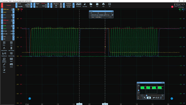

I am trying to optimize performance of a series of SPIM transactions using the 5340. Each transaction is 3 bytes long: CSN goes low, clock out 3 bytes, CSN goes high. Only the 3 received bytes matter here, the transmitted bytes are ignored. I want to minimize the turnaround time between transactions so that I can maximize the number of transactions per second.
I implemented a test using the 5340 DK and the NRFx driver, with SPIM 4 set up at 16 MHz with hardware CSN control. The SPIM END/START short is set, so as soon as one transaction completes the next begins. This should minimize turnaround time, since each transaction is started via DPPI and no CPU involvement is needed (in fact, for this test the CPU is put to sleep after kicking off the first SPI transaction). This seems to work as expected, transferring data from the sensor continuously.
However, I am seeing that there is a significant delay between the completion of one SPI transaction and the start of the next - approximately 900 ns. I am wondering what this turnaround delay is attributable to and whether there's anything I can do to reduce or eliminate it.
To get a better idea of what the SPIM peripheral is doing, I connected the SPI STARTED event to one GPIOTE task (toggle) and SPIM END event to another GPIOTE task (also toggle). Then, scoped these lines plus CSN and SCLK. An example capture is below. You can see there is an ~800 ns delay between CSN going high and the SPIM END event, which is larger than I expected. It's not pictured here, but I also measured the timing of the SPIM ENDRX event, which is 125 ns before the SPIM END event.

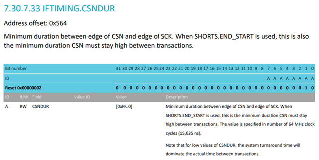

I found in the 5340 product spec that "for low values of CSNDUR, the system turnaround time will dominate the actual time between transactions". But, no mention of what the system turnaround time is or whether it can be influenced. In my case CSNDUR is set to 2, so it is only ~4% of the observed delay. I thought maybe the DMA is transferring the final byte into RAM during this time, but would have expected that to run much more quickly than ~800 ns.

4. I noticed from the scope capture that the SPIM STARTED event appears to occur after the CSN line goes low (~30 ns to be specific). I would have thought  Is this expected? I'm not sure if this is an artifact of the DPPI signal propagation or if the CSN line going low actually precedes the STARTED event.

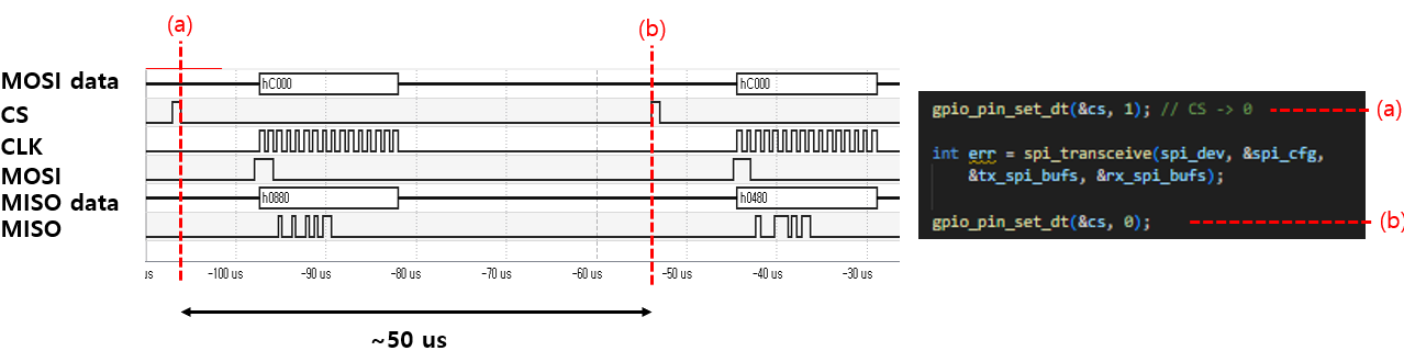

  • Dear sheindel-llt,
    I'm also an nRF5340 user experiencing issues with improving SPI4 communication speed.
    However, in my case, I'm seeing a huge delay of about 12us between the CLK and CS signals. (I've already posted about this issue, but it hasn't been resolved yet.)
     NRF5340DK High frequency SPIM communication failure / spi_transceive() delay problem
    I was wondering if you might be able to help me with this.
    You mentioned that you set the SPIM END/START short, and I'd like to ask how you implemented that. (In my case, the main code runs in a while loop, which seems to make the code very slow.)
    gwan0624
  • I would guess your delay is due to manually setting the CS line in the code. It's probably just the time between the CPU executing the spi_tranceive() and gpio_pin_set_dt().
    To eliminate this you can tell the SPIM to control the CS line directly (I believe there's some restrictions on which SPI peripherals support this). Look into how the nrfx driver takes the "use_hw_ss" field in one of the parameters to nrfx_spim_init() - I'm not sure if/how this would be done with Zephyr.

  • Thank you.
    I've changed the code to use the Device Tree for control instead of GPIO, but the results haven't improved significantly.
    It seems that manually controlling events using DPPI, rather than the SPI driver, is the correct approach.
